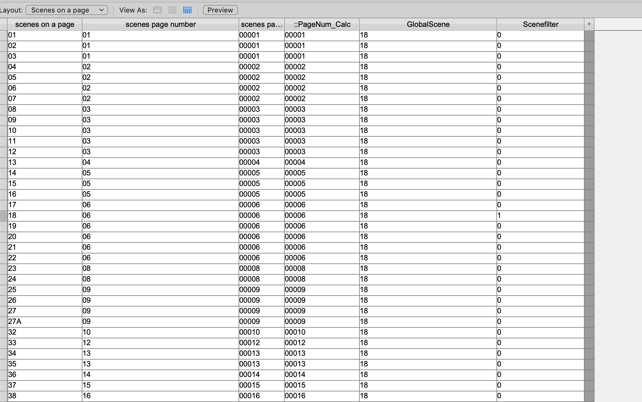

Thanks for the reply.   The DB has 2 related tables.  They are PDFs . "Pages" and "scenes".
I want to be able to on the "pages" table type a scene number and jump to the page record that contains that scene number.
I have constructed a table that works as a table of contents.
So when you enter the scene number in the global scene field, no matter what page you are on, it would go to the page  with that scene number.
in the attached table which is the toc, sc 18 is entered in the global scene field. using your suggestion a true value is calculated in the scene filter field. Scene 18 is on page 6. But i do not know how to move to page 6 in the table "pages".
So what objection do you have to the very first suggestion I made: perform a find in a layout of the Pages table, searching the related scene number field. All you need for this is a global field in which to type the scene number and the script shown in my first answer above. (In fact, even the global field could be replaced by a custom dialog within the script - but that may not be the most convenient user interface.)
i need all the records not just the found one
Then add the Show All Records step at the end of the script. The found set will include all page records, but you will still be on the one page record that was found.
thanks for your help. I got it working. Needed a few bits from around the web. I am pleased with the solution.
