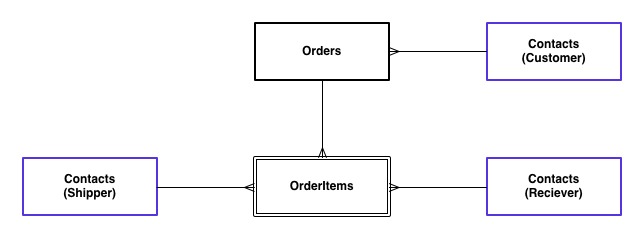

I have solution where "one address for customrer "   multiable addresses of shippers and multiable addresses of receiver on an order. that solution is for a trucking company  where customer is a load broker and carrier create a order where he picks multiable  items from diffrent location and there deliver on diffrent location ,
but all address are save on one table , so next time when  create order it paputale threre
It sounds like you should have:
where Contacts is a single table with multiple occurrences on the relationships graph.

when Join Contacts(shipper) and Contact (Recriver) with orderitems ,do I use single ChildID for both or two ChildIDs , one for shipper and one for receiver ?
and also when I papulate contact (customer) on Odrer do i use  "lookup value".
Edited by saghira
If (!) I understand your question correctly, you should have separate fields for ShipperID and ReceiverID in the OrderItems table - both matched to the ContactID field in the corresponding occurrence of the Contacts table.

In the logistics company solution that I support, each Job has two addresses (pickup/delivery). JobAddresses are then assigned to a Route (allowing for a pickup on one day by Truck1 and delivery a different day, different truck).
Adding an jobaddress to a job optionally links that address to a customer. We’ve also decided to optionally save the jobaddress as an Address. Often, we’ve found that not all delivery addresses or pickup addresses need to be either linked to a customer or even saved to the master Address table. They are a one time thing and a jobaddress is all that’s needed.
route->jobaddress <-Job<-Customer
There is also a separate relationship for each Job to JobObjects, the things either delivered or picked up on a route.
