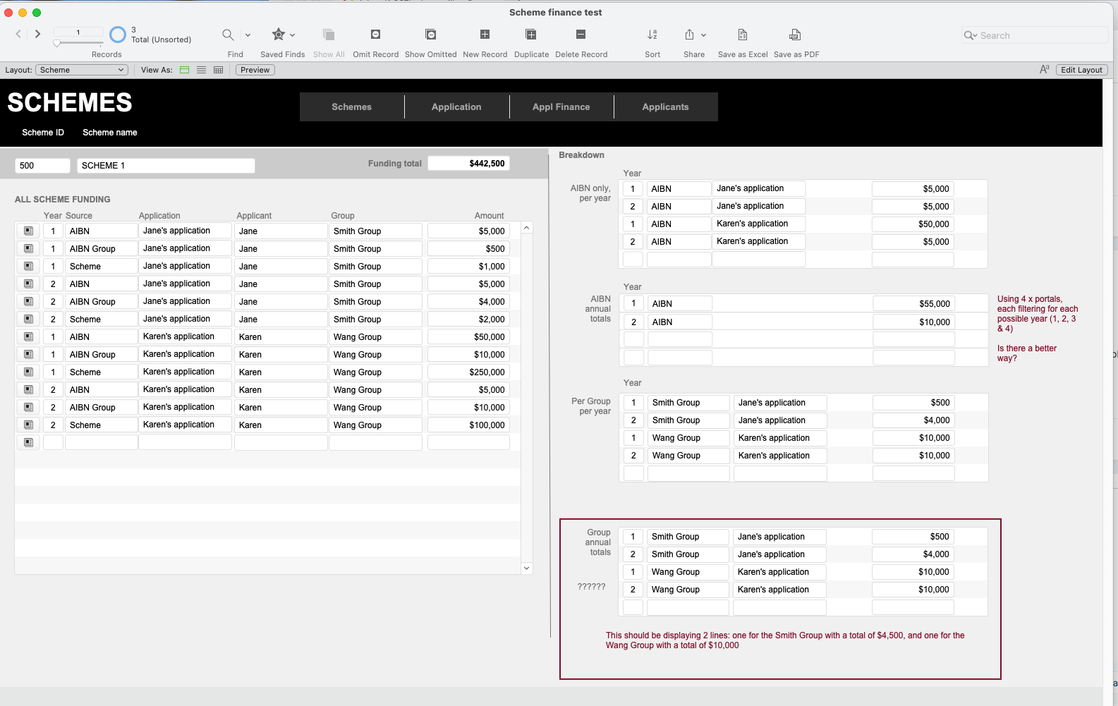

I have attached a sample version of my database here, which I hope will help.
My set up: We have grant schemes with applications. Each application is applying for funding which will come from a variety of sources: some from the scheme, some from us ("AIBN" in the database), some that the applicant needs to provide themselves ("AIBN group" in the database). There are numerous groups.  The funding is also provided across several years, so AIBN might provide $50k in Year 1, $20k in Year 2 and $30k in Year 3, a total of $100k. Most schemes are only across a maximum of 5 years.
Funding is added to the Application record via a portal linking to Finance.
I want to show, at the Scheme level, a summary of funding for that scheme as follows:
  1. All for the whole scheme
  2. For the AIBN only, each year for each application
  3. Totals per year for AIBN funding only
  4. Funding per year per AIBN group only
  5. Totals per year for each AIBN Group only
My problem: I have achieved 1 -  4 above, although option 3. is using 4 x 1 row portals each filtering for the year (1, 2, 3 or 4) - any suggestions on how this could be done better are welcome
I cannot get option 5. working. I have been looking through help and trying different samples, but wonder if my issue is complicated by the three levels: Schemes - Applications - Finance? I tried using another
Thank you for any assistance
Scheme finance test.fmp12

I want to show this information on the screen, not in a printed report, so want to use portals to show the funding for each application within a grant scheme in different ways, but am having trouble doing that.
I attached a sample database to my original question to help demonstrate what I would like to do, but perhaps the attached screen shot will help.
