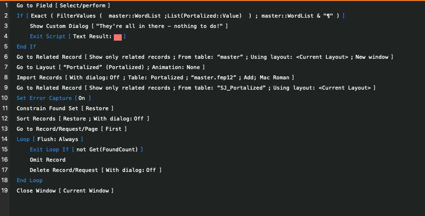

This is another way to approach the matter, without the use of variables at all, but instead utilizing native filemaker functions:

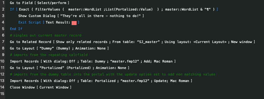

Well repeaters as source does not allow the update option to work, but a Dummy table can then receive splitted repeaters into indivual records, and from the Dummy into the portal, now allows the update and adds remaining.
The scripts boils then down to 11 lines if the comments are omitted:

I’ve done stuff in this way for years, and find it much faster and more safe against recordlocking! But the present have a little flaw in not cleaning up the littering.
—sd
Edited by Søren Dyhr
No clue what you mean by that.
The import in the dummy should be erased at some point, if say you have this script running 10000 times each day, would it stack up - without being at much use to anyone!
Yet another issue is, psos’ing as well as webdirect doesn’t support importing between internal tables that well!

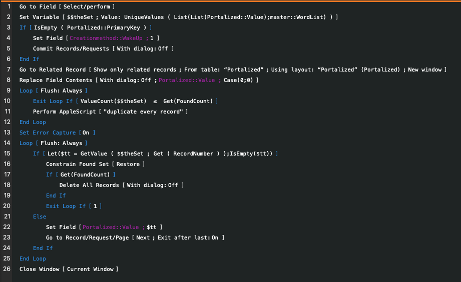

If you're on a Mac OS version of Filemaker, could this be done instead - Which in my humble opinion is pretty fast and needs next to nothing to maintain.
master.fmp12
