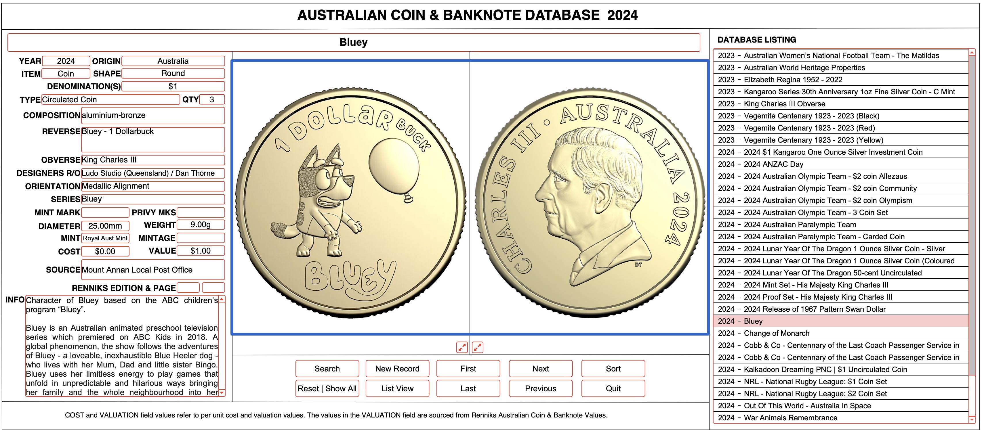

I am experimenting with the use of popovers on a coin database I keep.
Refer to Image 1: I have added 2 popover buttons, one in the bottom right-hand corner of the first coin and the second on the bottom left-hand corner of the second coin shown in the database.
The first button, when clicked, is designed show an enlarged picture of Bluey while the second button, when clicked, is designed to show an enlarged picture of King Charles III. At the moment, when I click either button, I do get a popover with the enlarged image – but not the size/location I want (See Database).

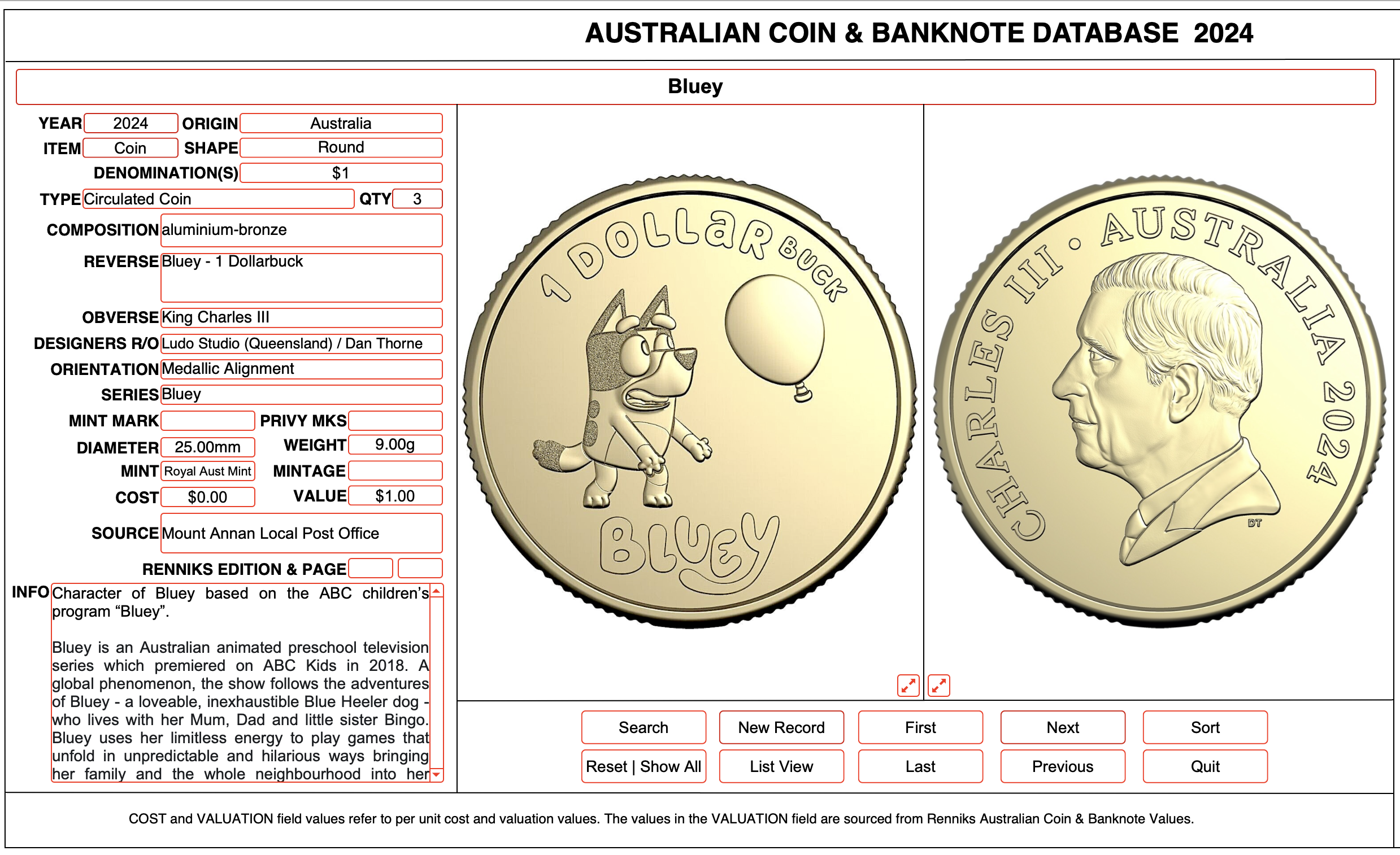

Here is my wish: when either button is clicked, I want the popover to cover exactly the area covered by the blue rectangle, as shown in Image 2. In other words, I would like the popover to cover the images of the 2 coins completely.
My issue: When I try to resize, I am unable to select exactly the size of the popover I want. Dragging the corner or middle resize handles on the popover to create the size of the popover I want does not work – the popover resizes to another size either bigger/smaller compared to what I want.

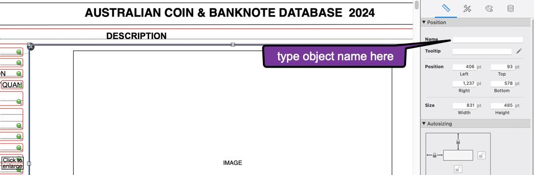

So close!!  Select the image popover (in layout mode).  Notice that you lack the object name for the popover (attached).
And sorry to tell you but ... your concept of placing the popover in the exact location will still fail if you resize the window.  This just reminds me of why I was so glad when card window feature was added!  Some of these old techniques were kludgy so your mileage may vary.
