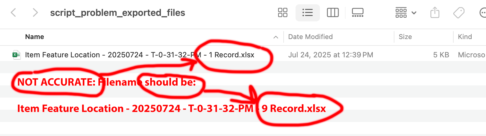

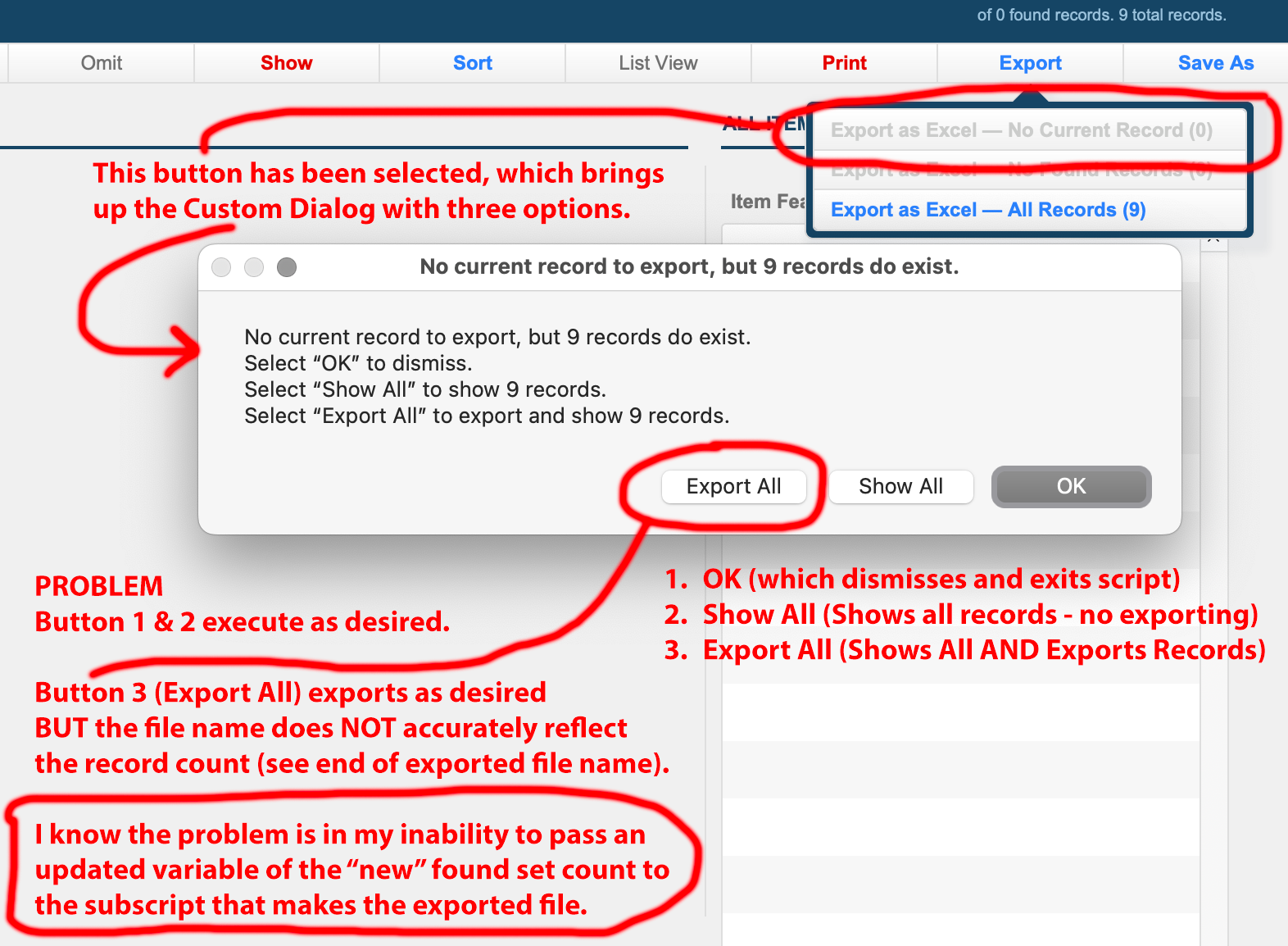

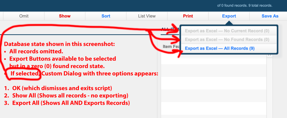

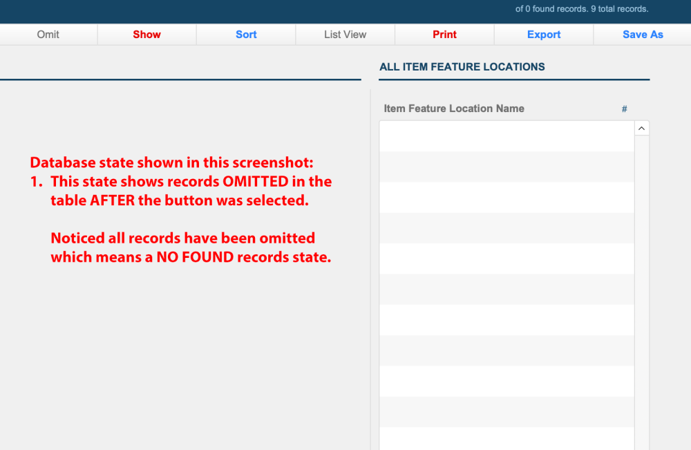

I can not figure out how to pass a parameter to a subscript to be used in the filename when exporting records to excel if a user selection in a custom dialog window changes the found count of records.
The problem is not specific to the export to "Excel", but rather my inability to get the updated "found count" into the exported filename. So, in this aspect, I consider this a variable that needs to update before it is processed by the variable calculation that "makes" the filename.
I know my problem lies in the "second" level of branching that can occur if User selects an Export button when (found count = 0) which I think would be rare, but possible. I also understand that I could get around this challenge by getting rid of the third button "Export All" found in the Custom Dialog I present to User: I consider this the "second" level of branching.
Since I am choosing to NOT circumvent the challenge this poses to me, and in spite of the fact that what I am trying to do might be "convoluted", I am planting a flag in the ground in order to learn how to pass parameters to subscripts, or to update a variable as a script runs based on User input or selection via custom dialog.

This is a little too much to take in all at once. Consider simplifying the issue and/or breaking it up to individual points.
Speaking in general, the script parameter remains constant throughout the life of the script, while a script variable can be defined and redefined at any point. If you want to export a file using a variable as the file's name, and the file's name is supposed to contain the count of exported records, then of course you will want to define that variable as close to the export as possible and not before any event that can modify the current found set.
HTH.

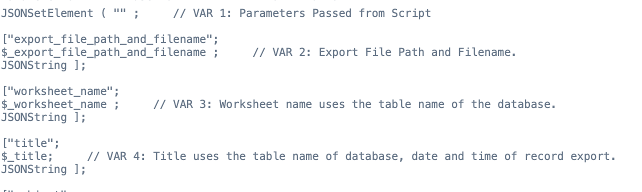

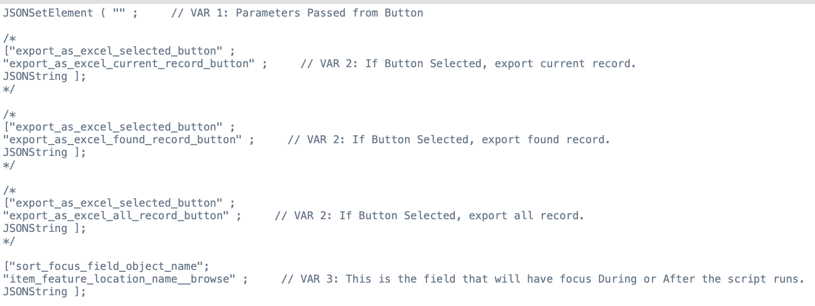

Okay - after much effort I got what I wanted to work with your help - thank you Comment!
Again, I'm brand new to JSON, still a newbie in passing a script parameter, brand new to passing multiple parameters, and brand new to passing multiple parameters to a subscript.....whew! It's been quite the challenge and I'm sure I can improve and refine this as I gain a bit more experience.
With all that said, can I get any validation/verification feedback if what I have done below is GOOD or BAD practice? Even though I got my script to work, it does not mean what I did is a valid/proper way of doing so.
1. I used JSON to pass multiple bits of "information" into a script to be used throughout the script. I "converted" the JSON "bits" into variables for the script to utilize.
2. The script then "calls" upon a subscript in various If/Else situations. Here, I need to once again pass parameters to the subscript.
3. I used JSON once again to pass the parameters to be used by the subscript. However, what I noticed that is different in this "second" JSON data set is I am using the local variables defined in the "parent" script itself. I think this works because this second parameter "set of information" is obtained FROM the locals variables while still operating within the parent script and "saved" as the parameter and "sent" to the subscript for its use?
See screenshots of the two different JSON "objects?" that I created: one for the "parent" script, and one for the "child" subscript.
If this is considered "good", I am going to consider this arduous lesson over and I can lean on this method moving forward to pass bits of data to scripts/subscripts. If it's bad I need to correct it before I build a bad habit.
Any feedback appreciated - thank you.
JSON FOR "PARENT" SCRIPT
JSON FOR "CHILD" SUBSCRIPT
02_json_script_parameter_for_subscript.thumb.png.1d891cafeaf1963e128c41fa2c04a77c.png
