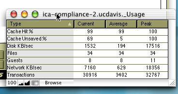

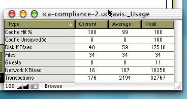

October 6, 200223 yr Well, here's one of my clients: G4 933 tower, os x, 256 megs PEAK values: Disk: 17516 Files: 34 Guests: 11 Network: 11576 Transactions 32767 BEVIN
October 6, 200223 yr Author What are the drives? Is that serious 17516 KB/sec? And 11576 KB/sec network? And 32767 transactions? If is it all serious peak figures that are great from single FileMaker server! What are those Guests processing?
October 6, 200223 yr Well, I'm trying to be serious, Anatoli ; ) Hopefully I'm not giving out bad numbers; they're copied straight off the remote server admin usage window. In terms of extra info, one 80 gig HD.. I just did some testing and found where I get my peak values, in part. There's an update/import script run every morning, where the 1000 files are updated by 3 match DBs and 2 match excel files (each match file up to 5000 records). This got me right to my peak transactions... The one client (which runs unlimited and does the import) has probably handled up to 500 simultaneous users during its peak period, when the students are signing on to the system at the beginning of the academic year, although I can't imagine that as individuals they are taxing the system much... Bevin (PS--this is the client who is looking for a FT solutions administrator (see the posting under the help wanted section) to run my system and tend to other miscellaneous computer needs.)
October 6, 200223 yr Author In that case FMI screw up the statistic big time. We have similar scenario with script machine running big job on 500+ MB of data. The machine has 5 latest SCSI drives as Raid 10. You have probably excellent setup, but 17516 KB/sec from single HD and 2850KB/sec from fastest Raid? It doesn't make sense.

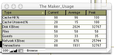

February 26, 200323 yr How come my numbers are so off. They seem impossible, but it's what I'm getting. Is the plug-in screwy for OS X or what. I noticed on the first page of this thread that someone else had similiar peak values, in fact a couple were exactly the same.

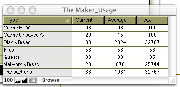

February 27, 200323 yr Hey guys, We get similar performance with an X server: Disk 12012 Files 51 Guests 10 Network 7260 Transactions 32767 I can drive transactions to the peak rate by doing a sort on one of our larger files, or running a summary calculation in the same place. Near as I can tell, this is the maximum transaction rate. Carlisle
February 27, 200323 yr Author Such disk figure can be probably achieved in fastest possible SCSI array. Transaction figure is probably the same bug as in other examples.

July 23, 200322 yr Here are the latest numbers from our Linux box. All are peak. Disk KB/sec 10920 Files 16 Guests 9 Network KB/sec 4208 Transactions 32767 I have noticed through this thread that there are other servers with the exact same number of transactions. any one have any idea why? Michael
