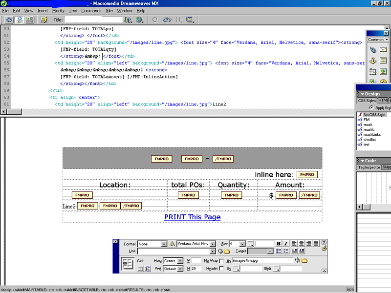

I am using it as we speak/type...
Dreamwaver MX...I have screenshot attached
forgot to say...Windows platform here
....what was the problem....DW is the same for MAc and Win....same folder structure.....read their ReadMe.txt file.If you have some trouble let me know maybe we can tweak it so it works for Mac as well!
lebisol
Oh! I'm a dope. Extracted all files to the path specified in readme.txt, instead of what was inside the "the files" folder. Working beautifully now, on W2K, btw. Thanks for the tip!
