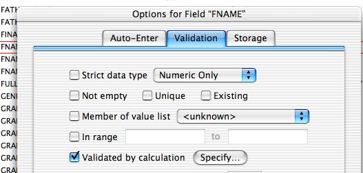

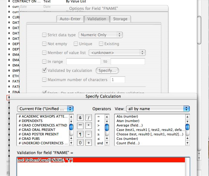

I had done exactly the steps you provided and still was able to enter a carriage return.

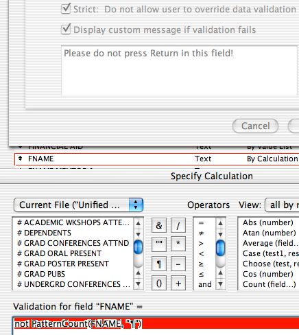

I now have added the message and selected the "strict do not allow user override" checkbox. After this, I still am able to enter a carriage return. When I click out of the text field, a dialog displays that contains my message and presents two buttons; Revert Field and OK. The OK button allows the carriage return to remain. Not good!
I have attached a screen capture (JPEG) to show you what I have done.
So I must still be doing something wrong and am desperately in need of an anti-duh pill.
Many thanks, Lee.

The steps you describe, and the fact that the message appears shows that you did all correctly. After pressing OK, you will not be able to leave the record, or go to another field. For an instance the carriage return might look 'accepted', but to continue is impossible. In the end you have to 'Revert'.
Harryk

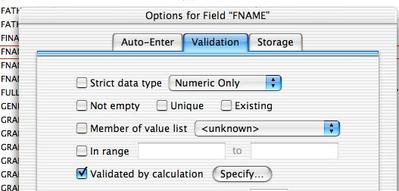

1. The calculation is included in that screen capture file I uploaded with my last posting to you. Were you unable to access the file or unable to open it?
2. FM Pro 5.5v2 for Mac OS X (Jaguar.4).
3. See the uploaded screen capture showing that it is in the Validation tab, not the Auto-Entry one.
4. Yes, it was. I deselected it, then tested the field, and it did not display the message. So I reenabled it.

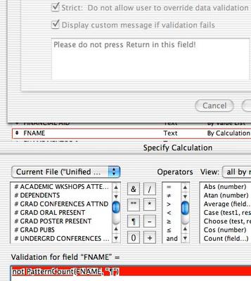

This is FMP 5.5v2 for Mac OS X (Jaguar.4).
To keep the file size at a minimum, my screen captures are showing portions of the dialogs.
I've attached another one showing part of the Calculation window.
The Aqua user interface of Mac OS X is a delight/pleasure (not strange) for me to look at.
Point your web browser at http://www.filemaker.com/images/screenshots/fm_collage.jpg to get an idea of what FMP looks like in Mac OS X.
Cheers!
