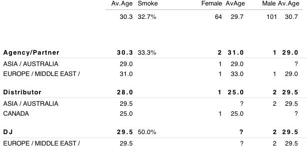

It is a divide by zero error. Here is the three fields I have:
stMale--Calc--Gender='Male' and DateBirth>0
stAgeM--calc--stMale*Age
stAvgM--summary--average of stAgeM weighted by _stMale
So if there is no data for the reported group I get a zero. Can anyone see a fix?
(I have attached a snap of the report created in FMP6)
Try displaying a calculated field based on the summary field like this:
Case(IsEmpty(GetSummary(AverageFemaleAge, theBreakField)), "N/A",
