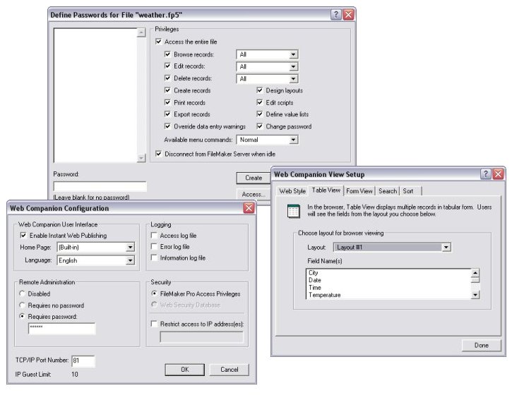

[color:"red"] Attached [color:"blue"]are the three screens that you refered to in the posting as they appear on my computer.
Nevermind. I got it. Thanks so much all of you. It was only a matter of putting the port number after the ip address.
