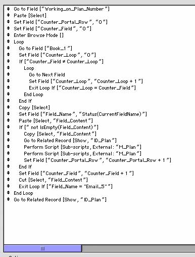

Cracked it, well, almost - so thanks for your help! I did it as suggested, with the script pasting and testing and, if the field is not empty, pasting to the destination; then going through a number of next fields until it gets to what was the next one, which it copies and tests ... i've included a screen shot of the script as an attachment.
THE ONLY PROBLEM blush.gif is that when the script goes back to the DB to paste the info into, it has reverted back to the first record that has a valid relation ship. It's a one to many relationship - so the "one" goes back to the "many" and picks the top of the pile, which might not be the one that it came from when the script started.
So sorry to be full of questions, but is there a way to keep the destination "many" from going back to the top of the pile, ie keeping it at the record that it was at when the script started?
In the script that i've included as a simple text picture the problem is at the line that says
goto related record[M_Plan] @JUST BEFORE THE TWO EXTERNAL SCRIPTS
So when the script starts, it is with M_Plan recordX being current, but then when the script goes back there, it has reverted to recordA - the top one.
Doh! and i thought i had it sorted! (My girlfriend wasn't that impressed!)
Thanks for any help, and especially to the guys that have already helped,
slater

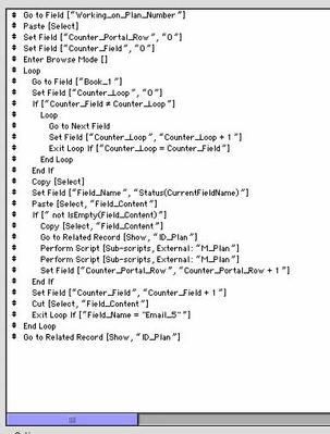

Fantastic - it's all working now!! So thankyou ever so much ... was really stupid of me to not think about making another relationship based on the unique id field for the DB i wanted to come back to ...
anyway, here's the script based in the "array" database as a jpeg.
Thanks again,
slater
