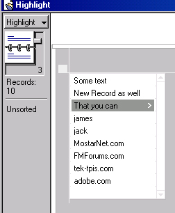

I am sorry...I thought that graphics are stored...click on the portal row.
Also, here is a screenshot of "how it is supposed to look"
if there is problem with graphics then simply paste an image (of solid color) int the field "q_ActiveSelection".
