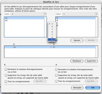

Same with 7 if you set your relationship with "x" rather than "="

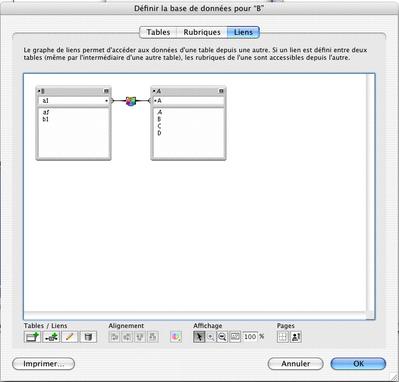

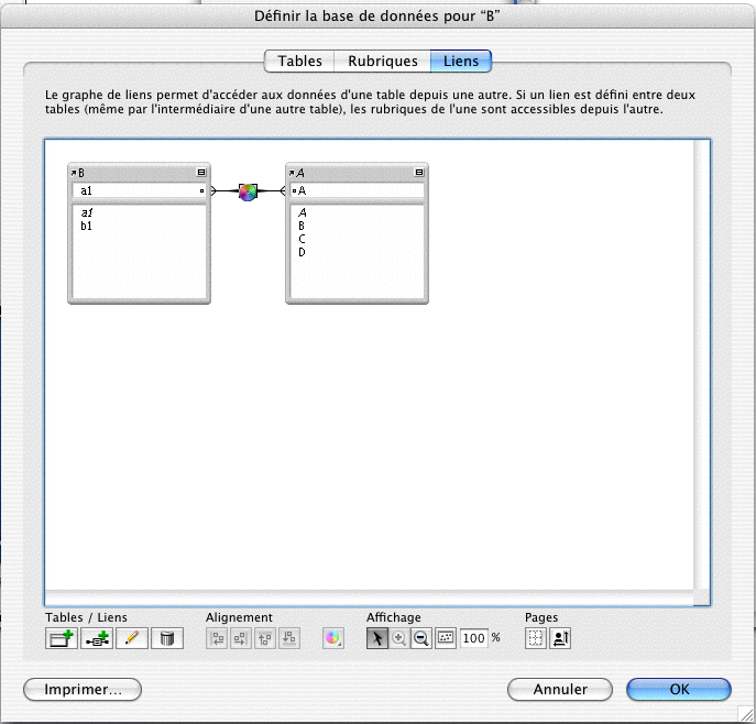

First step. Double click the link.
See attached screenshot
Next, select the kind of relationship from the menu list
Thanks Ugo, for providing the step by step instruction. I changed the relationship accordingly, but still can't see the value list in the find mode. I must miss something here frown.gif
