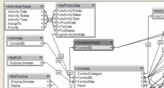

It does everything right up through copying the right record ids and pasting into Contactid field and it even switches to the final view. But what shows is all of them. I tested with debuger with 3 records in portal and verified the ids were those three. i put my graph picture here and here is my script. could you please help me one final time on this please? i swear I checked everything so i probably forgot to tell you something that made some difference somewhere. crazy.gif
each plays in script where it says go to layout, i made sure layout was based upon the right name and also that the fields matched that same TO. i checked types of fields and they are all text fields.

My graph file is attached. smirk.gif I hope
I just noticed that even if I use a layout on Staff Activities (my staff table) it or whether I use the TO of Staff All - it gives me all that Staff's matching contacts. I was trying to use Staff All because I have so duplicates of each of my tables. blush.gif I actually hid the tangled mess on the other side. I don't like adding all these tables because they get all tangled up.

How many lines does Staff Activities::gActivityWorkSet have after the Paste step? Is the global field actually on the Staff Activities layout? How is Contacts Main related to Contacts?
Ok.
How many lines does Staff Activities::gActivityWorkSet have after the Paste step? In my test, 3. If you wonder how many total might be displayed at one time, I guess all could. There are 36,000 contacts. They IDs are CON0000000 in seequence.
Is the global field actually on the Staff Activities layout? Checking script, the TO is Staff Activities and it has a global field displayed which is selected, called gActivityWorkSet and I checked that it is global text. Paste happens on layout named Staff Activities and says show records from Staff All. Ooops. The field is based upon Staff Activities but the layout is based upon Staff All. blush.gif Hold on!
Ummm, errr, those were the right questions for sure. shocked.gif I got so confused with so many staff activities and what is staff and what is activities. blush.gif I had two things wrong thinking I was point to TO when I was just naming the layout. tongue.gif And my copy was on Activities and not activities found - or was it the other way around. confused.gif Anyway, they didn't match right.
I need a bigger graph. I have over 70 of these TOs and I can't keep them straight because every time i want to find I use Go To Related. And every time I do that, i need a new TO. Geez. So sorry and thank you. You are very wise. wink.gif
