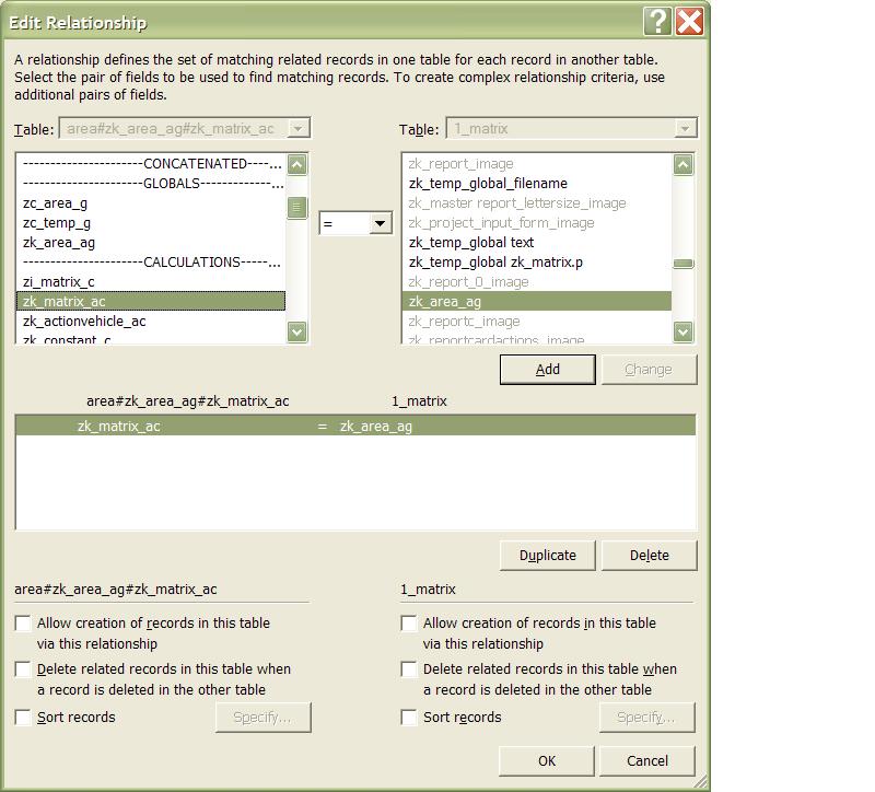

In dev6 this script works beautifully. In dev7 it sets the proper fields to create the relationship but the screen doesn't reflect it. I have discovered that if I go to the "Define Database" -"Relationships" tab, click on the relationship and pop open the "edit relationship" window, then exit back to the file, the screen changes to reflect the new relationship. What is that doing and how do I create that effect in the script. I have tried "commit record" but to no avail. Now I'm constipated!

Check your file references; I think you're using two unrelated files. If they are supposed to be related, then use the Relationships Graph to connect the primary key in one file to the foreign key in the other file.
They are connected. It seems more like a refresh/rewrite issue because when I open the edit relationship box for that relationship in the master file, and then exit, the screen refreshes with the proper relationship. Its like is sits dormant waiting for me to remind it that there is a relationship allready, then it responds.
Try using Refresh Window with 'Flush cached join results'.
How do you do that? ('Flush cached join results')
I tried Refresh Window by itself but it didn't work.
'Flush cached join results' is a script step option for Refresh Window in 7v3.

Queue and Ender, thank you! 7v3 'Flush cached join results' did it!
