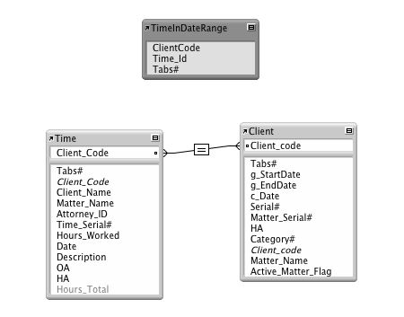

Ok I have seen that a few places but the first examples I had seen where with a 3rd table, with two global fields one for start and end dates. where the created date would be greater than the start date and less than the end date...does this make sense? Would this be a better solution than the example with the periods? I would like a system where even the most novice computer can use this.

If you have those start and end date into globals, then just set a relationship with them.
Now you can view the result either in a portal or with the Go To Related Records command
Ok makes sense here, just afew more quick ? Which table do these fields go in? All in the Client table? (Stanley)
Also what are these related to?(Ugo)
If we also wanted to search by attorney, client, client code, does this change anything or would we be just adding things to the scripts?
Attached is a screen shot of what I have at the moment based on some examples I have seen.
