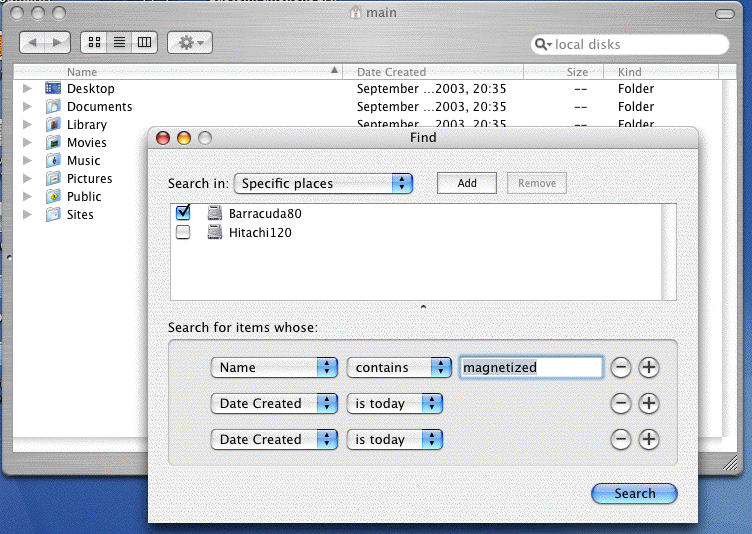

I don't think that's breaking the rules - provided it's presented as a dialog box (as I understand the poster intends). See attached picture.
Ahhhh... but the result of this MacOS X Find dialog is a new window... it does not change the contents of an existing Finder window.
I think that with FMP 7 this is the kind of multi-le-wuindoiw-think that we're going to have to adopt: be more respectful of the user's choices by being careful not to change anything they have set up unexpectedly.
I'm still getting my head around it, so please don't assume I know all of the answers. I still don't know what all of the questions are yet. wink.gif
Yes, but if you start in Window1 by clicking 'Search...', then Window2 pops up with "Define search criteria.. [Find]' - I don't think it is surprising or confusing to land back in the originating window containing the search results.

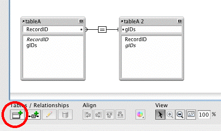

To be precise, you'd be creating a relationship between one occurance of the base table, and another occurance of the same table - IOW, a self-join. Nothing to it. Just place another occurance of the same table on the graph, and make your relationship (see attached pic).
Hi Comment, I created a relationship, from table1 to table1 2.
I perform the find, in my modal window, pass the the found id's to a global field, and then use GTRR, with my new relationship. I guess the relationship is working(although it could be the find), as the GTRR is finding the record, however its not going back to the the table in the background, its just going to the Form screen on the TO 2.
