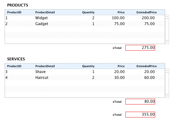

Example: a single field can return the totals for Products, Services and Invoice (see attached picture).
The same field could give the total of Sales to a Client, in a Month and in a Year and so on... all depending on the TO it belongs to and on the layout where you placed it.
