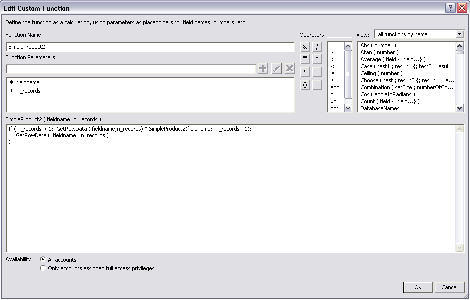

But...were is this ?
Product(fieldname; n_records) =
If ( n_records > 1; GetNthRecord ( fieldname;n_records) * SimpleProduct2(fieldname; n_records - 1);
GetNthRecord ( fieldname; n_records )
By open with FM8 trial I can't see it into the Define Calc list of functions.
By open with FM7 Dev it seems as you have named it:
GetRowData()
but it don't appears into the list of custom in 7, neither in 8 !
Ray,
In my version of FM8 it is under File->Define->Custom Functions...
I'm not sure where you are seeing "GetRowData()". It's not a function I wrote.
Hope this helps...Andrew
This is a screenshot of the lonely custom function that I see
