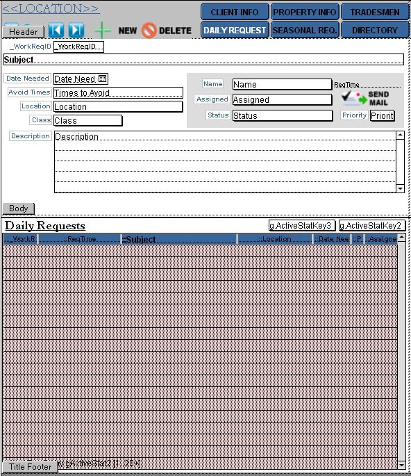

I have a portal (working perfectly thanks to mr_vodka) which filters and displays records based on their status (active, completed, canceled)-using global data.
Can I define it through an additional value list "class" being (maintainence, electrical, plumbing, painting or all)
The majority of the time it would be set to a default of 'all' but occasionally my boss would like to see if any one area is lagging.
As you can see I tried to just duplicate g.activestatkay2 with g.activestatkey3 but ran into the problem of the portal only being able to be referenced to one table at a time?
Thanks for your help

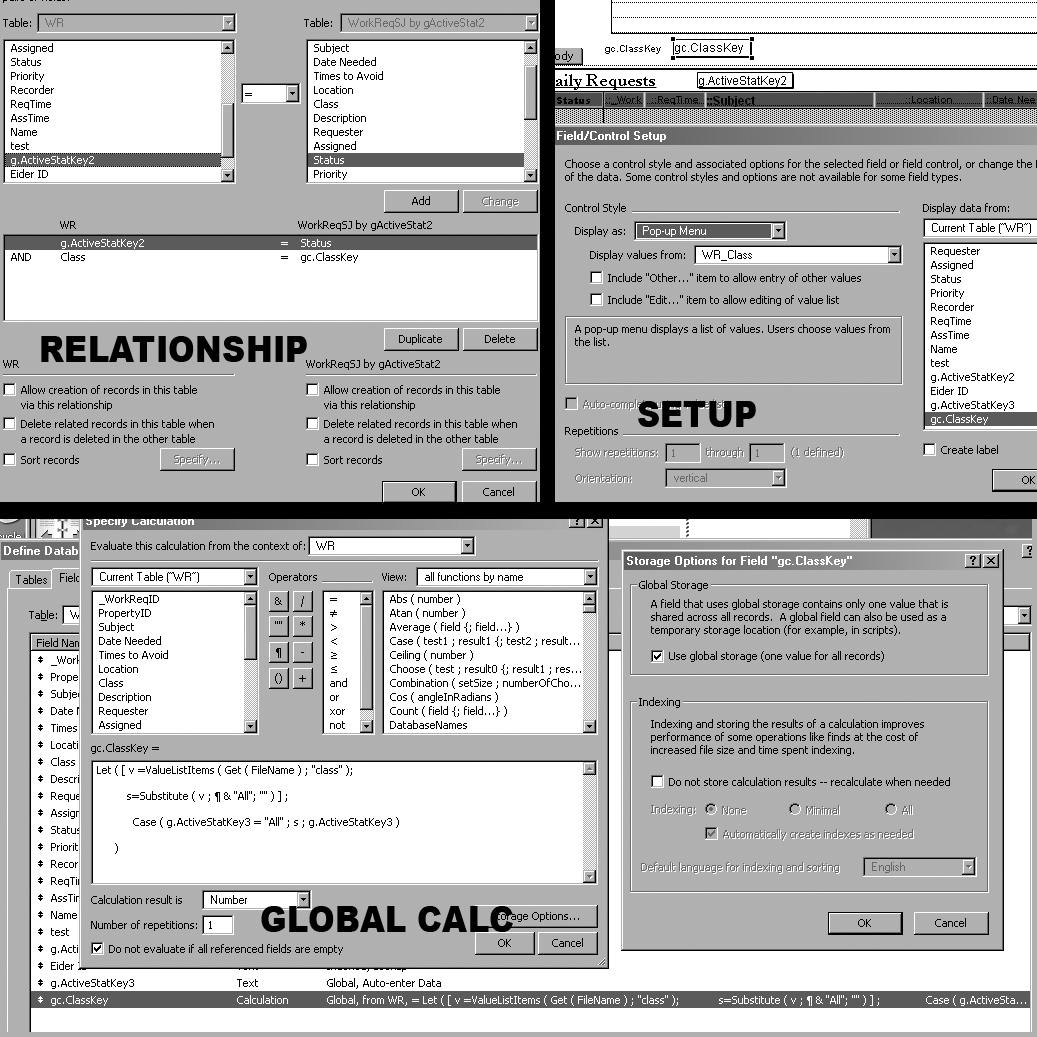

So I set up the gcclasskey field, made it a global calc based on your code mr_vodka;
put it in my WR layout and created a relationship between WR:gcclasskey & WR by ActiveStat:class
Then I made the gcclasskey field a pop up menu using the same value list as the WR:class value list
I think that is everything, so finally, I did something wrong because when I click on the WR:gcclasskey to sort the portal a pop up tells me the field is not modifiable?
Any thoughts? Thanks again for all the help
No WR:gcclasskey should not be modifiable because its a calc field. This field just stays in the background.
When you have the multiple relationship of:
WR:gcclasskey = ActiveStat:class
WR:activestatkey2 = ActiveStat:status
When you change activestatkey3, the value of gcclasskey will change automatically and thus change your relationship values.
This way, when your user chooses the value for the Active field, and also choose to narrow down his search more by the Class category (activestatkey3, which i would rename Classkey), it will only show for example, all active plumbing records etc.

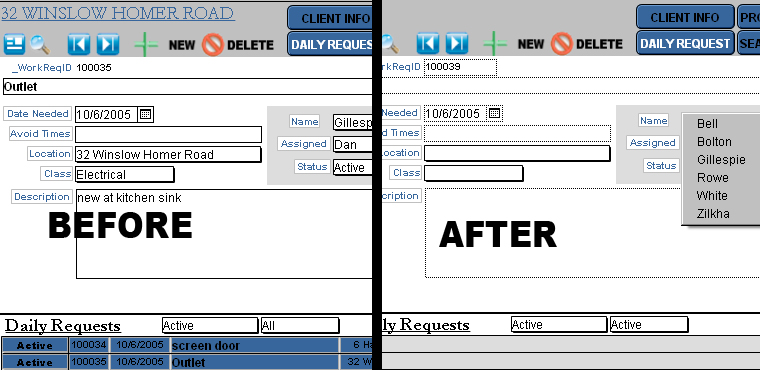

When I create a new record my ClassKey field reverts to the 'active' status of my gActiveStatKey2 field?
So my display portal will go blank until I select 'All' or 'plumbing' etc.
Any thoughts on this one?
So I guess all that is left then is to enter the data...hehehe
Thanks again for your help John
Since you copied the key field originally, it will retain the options from the orig field, being gActiveStat2. I think you copied it and called it gActiveStat3 right? Even though you renamed it Classkey, it still hold the option of the auto data entry value 'Active'.
So, go to youf field definition options for ClassKey, and change the Auto Data Entry from 'Active' to 'All' and you should be on your way.
