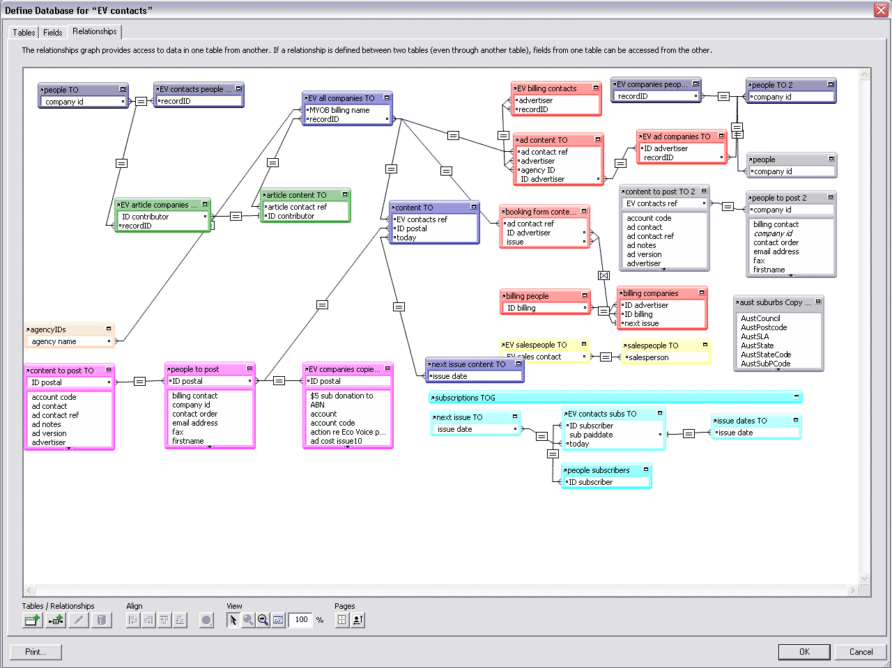

We have client card files set up, that display ad booking info and article submission info in portals. Around July, some records started failing to show up in these portals. At first it seemed to be any created after a certain point, but more recently the Ads Card File portal seemed to start working normally again (without anything being deliberately changed), while the Articles one isn't. I can't see a problem with the match fields. The ad / article records are created with a script from the Card Files, but I couldn't pinpoint a problem with the script either. Changing which TO the Articles card file is displaying records from, seems to make all relevant records show up in the portal, but much of the other info on the Articles Card File layout then does not display for *some* records.
And while I was experimenting with the Articles Card File the other day, the Booking Form (also a layout using a portal) stopped working properly. I can only assume that I changed something that affected other relationships, I don't know what. I wonder, and have had it suggested, if maybe there are just too many relationships dependant on one another, so that problems can crop up easily. I have attached a screengrab of the relationships graph in case that gives any indication.

I'm not sure I'm understanding you correctly as to what has happened. However, when a file starts acting differently, it is usually an indication that the file has become currrupted.
The best practice is to revert to a clean clone and import your data.
Make sure the primary key field and the secondary keys are of the same data type, ie, if the primary key is TEXT, then make sure that the secondary key is also defined as TEXT and also that they are STORED (indexable).
As for the deleted records showing up is that the primary key was deleted but the secondary key was not. To delete the related records you need cascade delete (by clicking on "delete related records using this relationship" found in the define database) which can also be very dangerous and yet so powerful at the same time.
