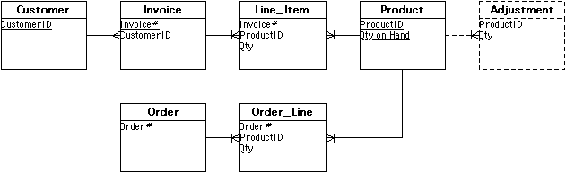

I have developed a basic solution for "customers," with related "invoicing," "products" and "line items." They all are connected through Customer ID, Invoice ID and/or Product ID and work great.
The invoices are typical in that they provide for a part number (which looks up information from the product table), along with product name, quantity, price, discount, line total and multiple product entry (through a portal to the line items table). This allows me to create product and invoice sales reports through the line items table.
My question is, what is the recommended way to handle inventory where it will keep a "product on hand" field accurate and does that field belong in products? I would like the file to be able to automatically deduct or add inventory into this field depending on whether a customer orders or returns products. I would also like to manually be able to add or deduct from this field to maintain its accuracy (as inventory is received or counted). Does it have to do with a calculation, look up or related file?
TIA
Hi Peter,
This is a good question that hasn't been visited in a while.
Presumably, you have a process to order, build, or assemble new items that are added to the available inventory. You might use a couple additional tables to hold these "Orders" and their line items. Then you could have your Product file compute what's available:
Qty on Hand (calculation, number result) = Sum(Order_Line::Qty) - Sum(Line_Item::Qty)
This works for the basic case, but over time, physical inventory may not match this difference between what was ordered and what was sold (things get lost, stolen, or broken.) So there should be some way to either account for the discrepancies, or manually enter the physical inventory. Another issue that can be problematic: when the line items have hundreds of thousand of records, those Sum() functions are going to get pretty slow. And finally, keeping the records from two years ago in the active file may not be necessary, so the method chosen should allow for records to be purged, with the balance Qty on Hand used as the starting point.
So taking these issues into account, my suggestion is to use the structure in the attached ER diagram, but then have the Qty on Hand field be a regular number field that gets updated via scripts. Whenever an Invoice is processed or an Order adds items to inventory, a script would need to loop through all the line items for that Invoice/Order and update the Qty on Hand by the Qty used for that line:
Set Field [ Product::Qty on Hand ; Product::Qty on Hand - Line_Item::Qty ]
and
Set Field [ Product::Qty on Hand ; Product::Qty on Hand + Order_Line::Qty ]
The issue you have to be careful of with this method is record locking in multi-user environments. The Product record must be commited right away after updating. Also a test might check that the Product is not locked prior to attempting the Set field[], and some method for dealing with the locked record should be considered. Maybe you just don't update the Qty on Hand in locked records until the end of the day or week, when a maintenance script runs through all the products to refresh the Qty.
You also asked about dealing with returns, these could simply be the Invoice with additional negative Qty line items added, or you might use another TO of Line Items filtered to only show returns, where a calc sees that they are returns and negates the Qty that the Sum() function uses (in both cases, the original line items are kept intact and additional line items for the return are added.) Or you might use a separate Return table linked to Line Items (probably the same Line Item table as for Invoices.) An approriate Qty on Hand update script would be run for these as well.
I agree. I am wondering though, if combining the best of the two methods wouldn't be possible:
Instead of running a script after every product transaction, I would run a script after every product count. The script would make all previous product transactions (LineItems and OrderLines) unrelated to Products. So QtyOnHand would be a calculation of
last product count + order lines since last product count - line items since last product count.
This is just an idea I've been toying with. Someone more experienced with large-scale files should comment on its feasibility.

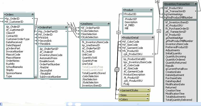

I am also needing to be able to do this. My biggest concern right now though is how to get my “products” to hook up with my “line Items”.
My product table has a unique number key (ProductID) . My problem comes with this. My Product SKU is made up of "Product::MilID" and "InventoryItemCode" (which is constructed of ColorCode+SizeCode+GarmentCode) and this is the unique identifier that I am using to order more of that product (InventoryDetails table)
Got that? OK, here's more. In my LineItems table a product is ordered just by the "InventoryItemCode" not the complete SKU. The LineItems do not care what actual MillID is chosen. There is a boolean flag that is set to yes or no that chooses the preferred MillID for the "InventoryItemCode" so we will know what our preferred brand of clothing is when it's time to order more. If the preferred is not available then we order from what ever else is available.
Since the LineItems table does not get the entire SKU, only the InventoryItemCode portion, how then can I relation to the Product/ProductDetail table? If I do LineItem::InventoryItemCode to ProductDetail::InventoryItemCode I am not getting all the information to get the Product::MillID.
Can someone help me?
I didn't see your query here until today (it's usually better to start a new topic for your own specific issues.)
I guess I don't understand why your Product::InventoryItemCode isn't the same as the LineItem::InventoryItemCode.
Are there more than one Product records with the same InventoryItemCode (but different MillIDs)?
Yes, Exactly. We have several different Mills of the same type of product. Example:
We can get
Small White T-Shirts
in Mills
1.Hanes
2.Jerzee
3.Gildan
with the prefered Mill being the Gildan
The only thing they need to know when they enter the work order is that the order is for Small White T-Shirts
Maybe I don't need it to hook up to the Products table? I am just not aware of any other way to keep track of QtyOnHand but to do it through the Products table.

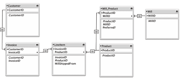

I'd suggest keeping the Product information separate from the Mill information by adding a Product-Mill table (or if the Mill is just an attribute of where the product comes from, add "Mill" as a field in whatever table you use to track the replenishing of inventory.) This way, each record in Product is unique to the InventoryItemCode.
When it comes time to pull or commit the Products from the Mills, use a script to set which mill the Line Items are comming from (it may be possible to have this as an auto-enter calc, but I'm not sure.)
I had a feeling I was going to have to do it with a script. I have the mill in a seprate table, I may not have named them well but, the Mill table is "Product" and the "ProductDetails" is made up of the size color and style of that mill.
I am stumped on how to create a script to insert the prefered mill and were to insert it. I guess I would insert the mill in the "LinesItem" table in order to join to the "ProductDetails" table right? I tryed that once before and couldn't figure out how to do a script to make it choose a flagged(Prefered mill) item.
Could you give me an idea of how to pull this off?
Remember, there is a picture of my TOG in this post for reference. Thank you so much.
Well, this is what I had in mind. You could place a Mill_Product portal in a layout based on LineItem, and sort the portal by Preferred?, so that the Preferred Mill_Product records are first. Then have the script check each successive line in the portal to see if the there's a Mill_Product records with enough Product on hand to accomodate the Qty needed in the LineItem.
Now that I'm thinking about it though, I might I'd try adding another TO of Mill_Product that's filtered by Qty, so that only those with enough Qty on hand show. If there are none, you'd then need to decide how to deal with it. Either splitting the order for that line among multiple Mills, or putting a hold on that line.
Anyway, once you decide which Mill to ship from, that would be filled in on the LineItem record, in the MillShippedFrom field.
