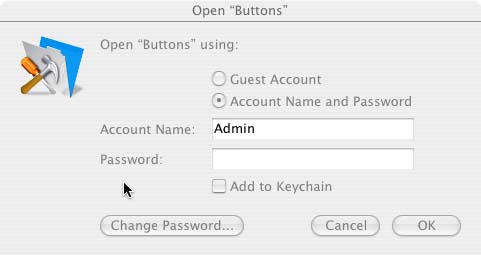

Hi
It logged in as guest when i opened the file, it does not prompt me. How to change it to admin? I can't find it..
Kelvin~
[color:blue]Account Name = Admin
erm hi.. sorry where can i do this to change the account name = Admin, i can't find it..
Kelvin
I'm not a Windows user, but I believe you Hold down the Shift Key when you open the file.
This will produce a dialog box for "Account Name" and "Password" (I was under the impression you were letting it, the Account Name, default to "Guest".
Just enter "Admin" in that box instead, and leave the "Password", blank.
add jpeg
Thanks Lee I learnt something new =)
