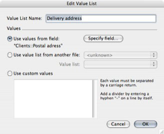

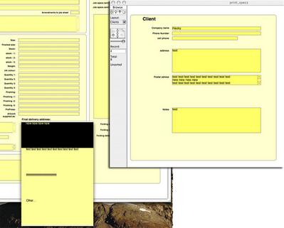

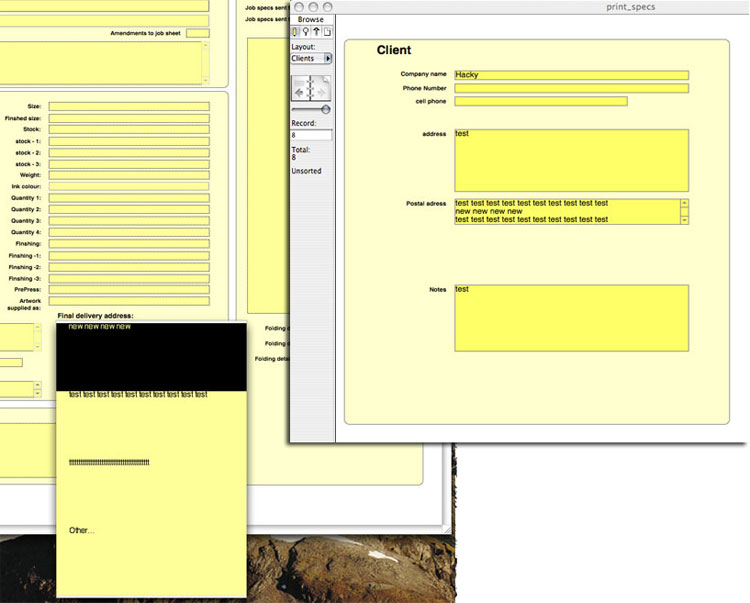

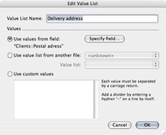

Hi I am have some trouble with data spilting in Pop-up Menu. The is data from an Define value list. (second screen dump show source ). If I enter the text in the source field and put return at the end text line and start a new line it spilt the data in the Pop-up menu but if there is no return in the field and text just Continues on and there is no spilt of the text on the pop-up menu.
I hope some one can help me with this

A return means a new line? wouldn't that be expected behavior?
Or did I miss read your question.
Hi Thanks for getting back to me
What I trying to do with the data from the pop-up menu is to display a postal address.
So the text needs to be displayed with (returns) i.e multable lines from the same Field. Is there some formating I can do at the source Field to change this?
thanks again
Hacky
If I'm understanding you correctly, what you are wanting is a conditional value list. Since you mentioned Postal, check out the Zip Code sample file posted in Sample Files Topic area, I think this is what you are after.
Anyway, multiple lines in a value list is a new one to me.
