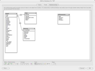

Background: I am trying to develop a database for faculty contracts & attendance. The dept already has one that has hobbled along since FM4 and has a great deal of issues. The goal is the database I am in charge of developing will replace the current one and will be able to grow etc. Although I have database experience, I am new to Filemaker. (version is 8.02 and using both Mac & PC).
I have several tables. People and Account are 2 of them. I have a relationship from People::acct to Accounts::c_Chartfield (this chartfield is a calculated field). I have data in the account- basically 5 parts that make up the 25 or so character account number (AKA chartfield string). Every year one component of the 5 parts changes to reflect the fiscal year (ie AAD05 will change to AAD06 on June 30).

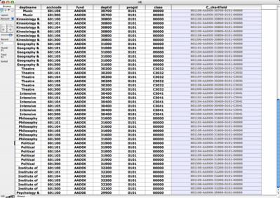

Attached: relationship and acct data images for clarification.

I actually made another table called job (which will hold the job and contract info)...so the relationship goes like this:
1 Person (people table) can have many jobs (usually one at a time though) and each job (or contract) will have 1 account number.
I still would like to maintain the historical records... ie last year the account for Smith's job was abc.... and accounts can be used by many people's jobs.

I hope that the 3 attachments will provide more clarity. Here an account number consists of 5 different parts (ie 60190-AAD05-29900-0101-C3033)
Every year the AAD05 will change to reflect the current fiscal year. So July 1st, the new account number will be 60190-AAD06-29900-0101-C3033.

Use fixed auto-entered serial numbers for the underlying relationships. These can then take care of themselves regardelss of fiscal year rollovers. The account number can then be changed at will without regard for breaking relationships.
Thanks... that's what I did on Friday- P/F (Primary/Foreign keys).... but my questions remain ( I know I haven't been clear as I should be-- things are just so muddled in my mind lately..... ) :confused:

The account table has the following fields in it:
Acctcode
Class
Deptid
Deptname
Fund
Progid
z_acct_pk
c_chartfield
the acctcode is 60190
class is C3033
deptid is 29900
fund is AAD05
progid is 0101
and the calculated field is c_chartfield and it’s calculation just concatenates the five parts (acctcode & "-" & fund & "-" & deptid & "-" & progid & "-" & class)
The automation should replace the Fund from “AAD05” to AAD06 or AAD07 (for 7/1/2006)
