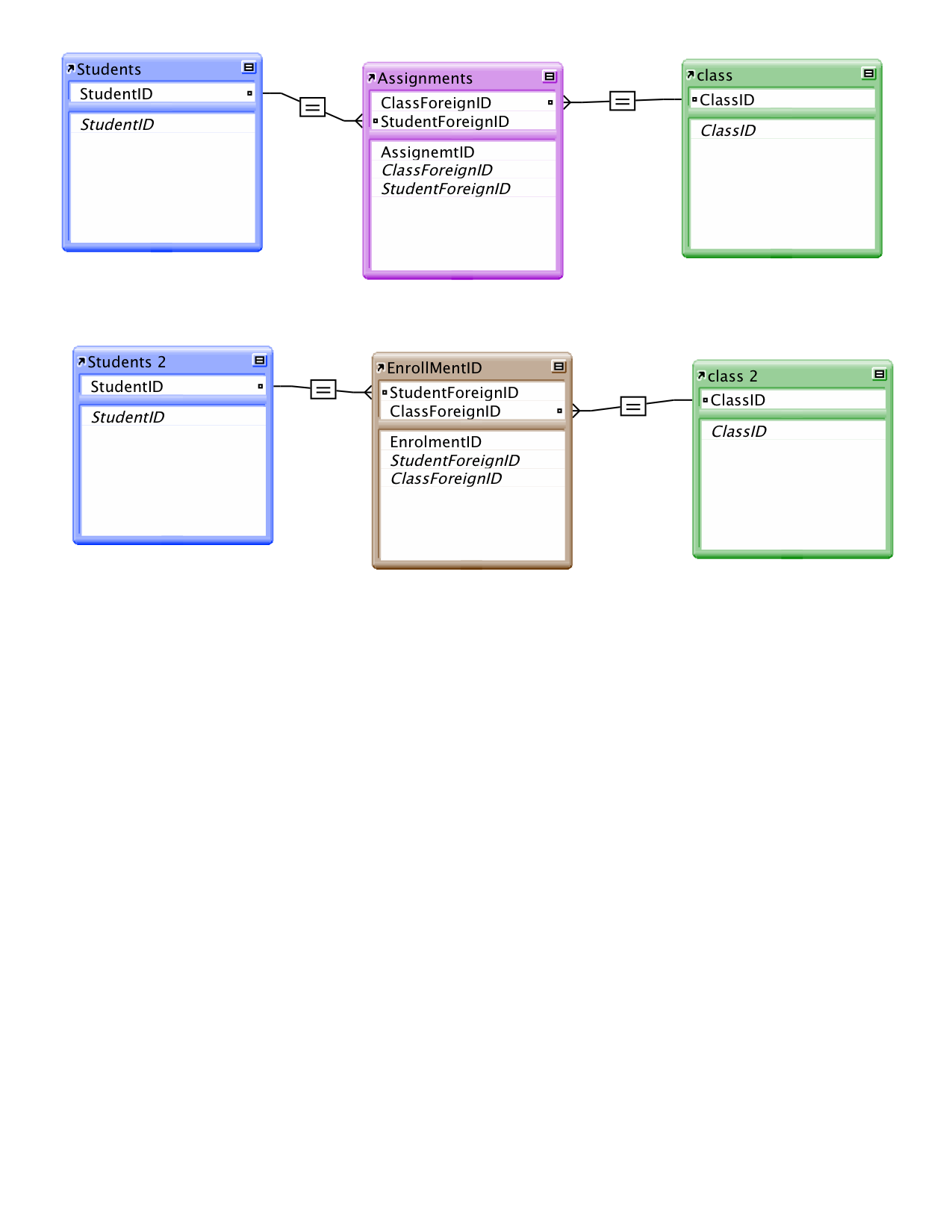

How about this:
Where do the scores go? That's what the AssignmentResults table was for. There are many assignments in one class, many results for one assignment (One for every student in the class). The assignments don't need to be related to the student, the scores do. The biggest problem with the relationship graph you posted is that the scores can't be related directly to the student. That would cause you to see all of that student's scores summarized together. They need to be separated by class. That's why the AssignmentResults has to be related to the Enrollment table, not the Students table.
I'm not having any trouble with the relationships. The entire solution is working perfectly. I was just looking for a faster way to automatically create records in the AssignmentResults table after creating an Assignment. Right now, I'm using a loop. It creates the records so all the teacher has to do is create the assignment, the records show up in a portal, and the teacher enters the scores.
To the enrollment table, which ought to be called single_tasks instead. I think I'm able to do get similar functionality by making the join-table a star (tri) between 3 TO's Class, Student and Assignment. What it does, is that you can see eaverything a relation away without having to rely on lookups at all, but instead could access data in tight spots via an unstored calc'field.
I attach my rough, with carries a bug or two, but as I see it as I also suggested yesterday, shoulc enrollment instead establish a set of ID's to choose from. Methinks that such a matter easiest is established by splitting the graph in two (3) one to taking care of making a valuelist work in the next graph ...giving a found set of students to assing task to due to their enrollment. At present is it a carthesian produkt relation making all students availiable.
Then is there the third graph (second because I havn't made the enrollment thingy), which owes it's respect to Geoff Canyon, who suggested this as a way to assing markings/grades results in an article in Advisor this Sept 2005 called "Use Dynamic Relationships to View Data"
I think I could get away using this layout alone by turning allow creation of related record, and systemizing the generation of Valuelist, but it's just there to show another approach in adressing the data.
But by'n'large do I think that your relations are inconvenient! Then to your question how to enter an entire class to a new tasktype. Well If you know all the ID's of the student's you wish to assign, could you put them in a textfield return delimited.
Then in a new calc'field could you split each ID via Get(CalulationRepetition) provided that the calcfield is large enough. What it then takes is store the two remaining ID for Assignment and Class in a pair of global. Single out the record it's done in by:

But why not poke into my approach to the present problem with the relational structure as well??

I did not understand your demo - I suspect you're talking about a different situation. Here, the assignment is given to an entire class, not to individual students.
This is where the knowledge of the studentID's (from enrollment) comes in, by say ValueListItems( or GetNth( they are stuffed into a textfield that gets split by a repeating calc'field utilizing Get(CalculationRepetition) and import between tables.
It's not in the template yet, admitted!
I think I may be beginning to understand where you are going with it, but the relationship still can - and IMHO, should be - as outlined by OP above. That is, there should be only one enrollment record for each student-to-class occurence.
You can just as easily get the VL of enrolled students in the Assignment record, and import the 2 repeating fields into AssignmentResults. But it requires a layout with enough repetitions. And I'm not too keen on having core data depend on a script, either.
Except that Assignment_Result_by_Student is wrongly positioned
But then take a closer look at the apparent lookups.
Assignment Description shouldn't belong to both the tables for Assignment and Assignment_Result unless one of them is an unstored calcfield if it "...along the path" can't be seen. The work of a Lookup isn't required at all, and will burden the responsiveness ...unless the students should learn to benefit from chasing an ever moving target. In such a case should the agility belong to the student table instead. I suggests that if a value can't be seen "...along the path" then yet another TO instead of jumping into either lookups or unstored calcfields.
Nor neccesarily wrongly, just less conveniently. And yes, some of the fields seem redundant.
