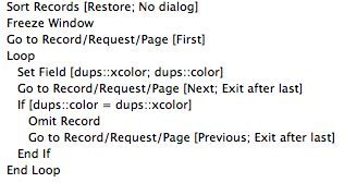

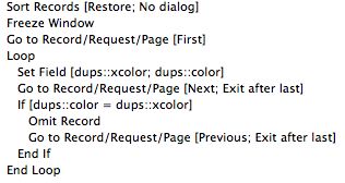

After you perform a search, I could write a script that omits any duplicates records. The question is, which duplicate record do you want kept in the found set? Do you care? Do you want the first one created? Do you want the last one created? The following script will omit all duplicates except the first created. Let me know if you want something different.
The screen shot shows the script. You sort by the color field to get evrything in order and then loop through all the records, omitting duplicates.
