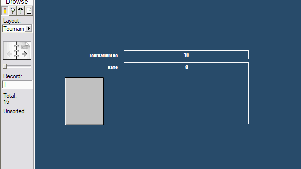

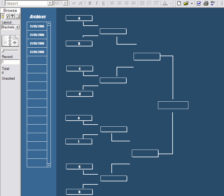

Its kinda hard to explain but those white lines are the buttons inside the corresponding portal, each name box is the same portal set to display one related record. So the first displays the related record No1.Two displays the second related record.
The related record has a field called tournaments entered.If say the name in the first box wins. I would click on this first line, i need it to then go to the related record of the name in box 1 and add 1 to tournaments played, and also do the same for the opposing box. I dont want to have to click both lines to update the thing.

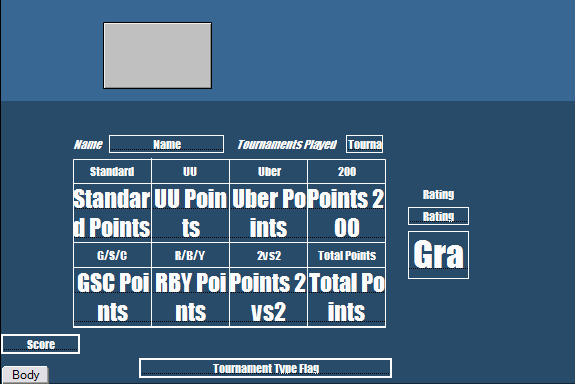

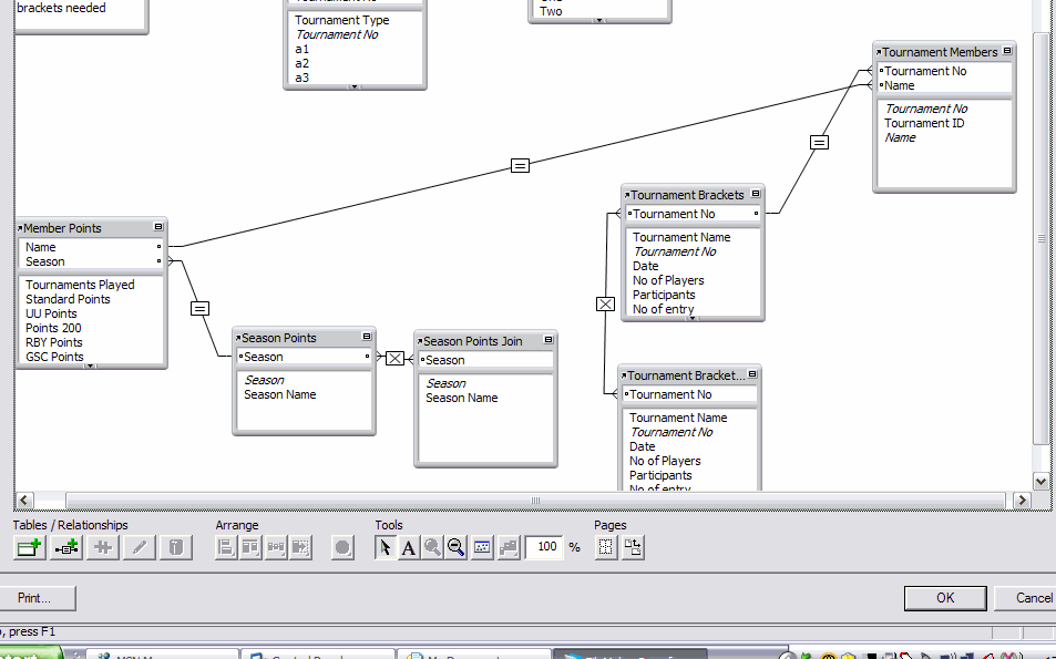

Screen shot one shows my relationships,two is the related record i need to go to.It is a layout of the table member points.

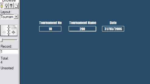

3 is where i enter players into a tournament its an 8 man tournament so 15 records have been created,the amount of name boxs required for an 8 man tournament.

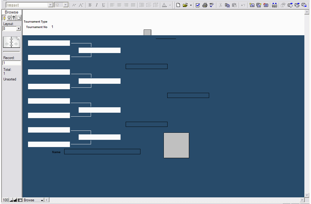

Screenshot 4 is where is set up the tournament.

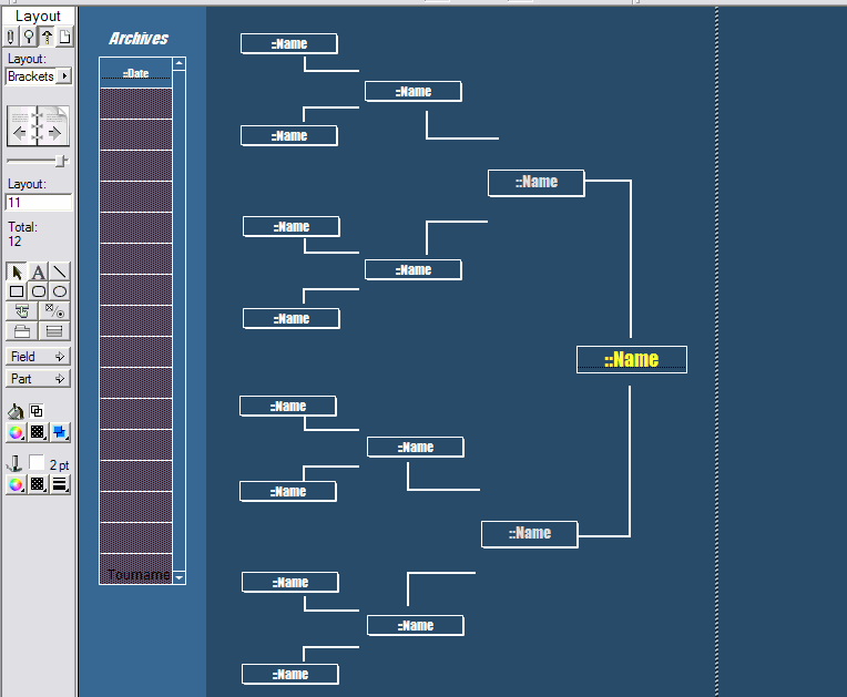

Each name box is a portal set to show one related record of the member entering tournament screen, the lines are buttons.
What i want to do is say a beats b i click on the a line, it will go to the member points of a and add 1 to tournaments played, but also go to the member points related record of the opponent in this case b and add one to tounaments played.
The only thing holding player 1 to player 2 is their natural sort state of creation order (in the Member points table) portal? And you are displaying the same portal (duplicated) and respecifying the row to display? So you NEVER sort the portal or the Member points records or relationship? What if a player dies/quits? You can’t insert a player in their place … ALL players would move up. Is that okay? After the first round, how does a player move up? It looks like you are displaying the next round up using the SAME field/portal as the first round. Will you create another table occurrence of Member Points (filtered with only the winner) and use a different portal (but same theory) for the next round?
Adding a 'tick' count to a tournament member each time they play is error prone (for several reasons). Besides, why count when proper structure could just Sum their matches? Also, the join is on member NAME? What happens the first time you get two Bill Smith’s? If the lines are outside the portal, you will need a different script parameter for each line, specifying 1, 3, 5, and 7. Pseudo-code script for first set (script parameter of 1 ). Repeat with each set in round 1 (use same script) but attaching 3, 5 and 7.

This script is only speculation - much depends upon many things. ohhh, THAT is deep. :bigshades:
The reason the one script-step MIGHT replace the blue is, if portal 1 and portal 2 are only related because one is after the other as records in Member Points table then you don't need Go To Related[] to get the second player. It will be the very next record (after you work on the winning player). But if there is a sort ANYWHERE, you will need to use the blue. Depending upon RECORD ORDER for a relationship would terrify me. Your structure confuses me, feels off and seems incomplete - but I want to help you. Problem is ... I can't help with something that I don't understand. Maybe others see it more clearly (please).
