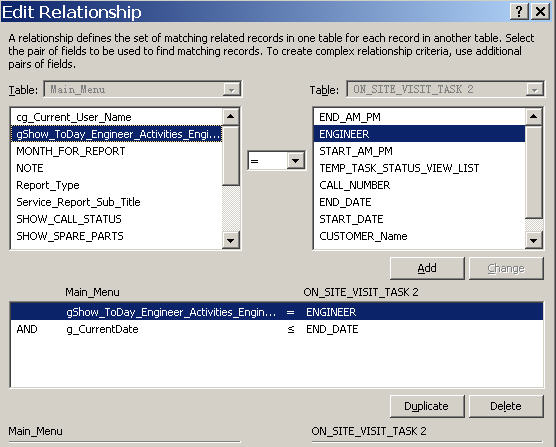

Finally I found it's much easy to use g_CurrentDate<=Service_Call_End_Date relationship to list all call not finshed.
g_CurrentDate=If (IsEmpty ( Main_Menu::gShow_ToDay_Engineer_Activities_Engineer_Name ) ≠ 1; Get ( CurrentDate ) ; "" )
Attached is the screenshot.
