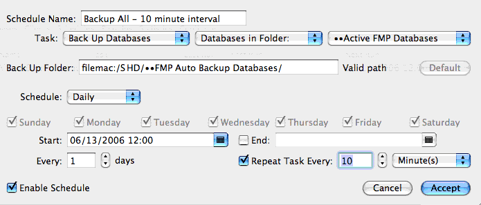

FM8 Server - I am trying to create a schedule to backup all files every 10 minutes but it is only backing up once per day. I tried daily repeating schedules and also weekly.
What am I doing wrong here?

Are you updated to 8.03?
There were some known issues with scheduling in previous versions.
We are running 8.0v2. I will try upgrading to 8.0v3 after the current shift and see if it solves the problem.
