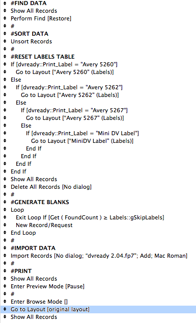

I want a popup menu where I can choose to what layout it should go like in the last example. I use
Your Generate Label Script and added a if else if.. steps to go to different layouts, but it wont work! It stayes on the main layout and wont do anything!

I can't see anything obviously wrong in your script. The only thing I can suggest is to try and isolate the problem, e.g.
If [ selected = "Layout1" ]
Go to Layout [ Layout1 ]
Else If [ selected = "Layout2" ]
Go to Layout [ Layout2 ]
Else If [ selected = "Layout3" ]
Go to Layout [ Layout3 ]
Else
Beep
Show Custom Dialog [ "none of the conditions evaluated as true" ]
End If
Now I'm getting the show dialog error msg.
Here the file!
It seems it doesnot like the script steps to go to different layouts! If I remove those and just leave the go to layout without the "if" stips it works.
help.fp7.zip
No, what it means is that none of the conditions evaluated as true. It seems to work if you select Avery 5262 or Avery 5267. Avery 5260 is not in the value list. All the other options are not (yet?) provided for in the script.
