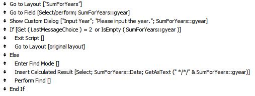

The easiest way is to use a summary field for the Hours then perform a find on the date range for the year field, such as, 1/1/2006...12/31/2006.
(In FM8, you can simply type */*/2006 instead of the old date range)
Your summary field will then show you the total hours for the year 2006 or for wahtever year you perorm the date range for.
Create a new field, "sum_Hours" and define it as summary, and for the options select "Total of Hours"
You can also script this process if your users will be doing this processing often.

I don't know how you have set-up your relationships, but based on what you are teeling me, I would add a new calculation field in the courses table for Course_Year and use it for the relationship to get the sum of hours for a particular year.
Course_Year = Year (Training_Date)
I would then create a new table to hold the years and use this field "Course_Year" as the key field.
I can set-up a sample database if you'd like to use this approach.

Jim, here's a quick sample. It will give you an idea of what I'm thinking.
SampleTotalYear.zip
