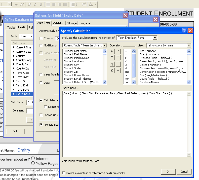

OK, here's what I've got. I can't really post the file here because it's got a bunch of addresses in it, but hopefully this is useful.
Thanks so much, folks!
OK, this is not a calculation field - it's a Date field with an auto-entered calculation. Go back to Define Fields and change the field Type to Calculation.
Well shoot, I guess I showed my ignorance. Thanks for the help all - problem solved.
