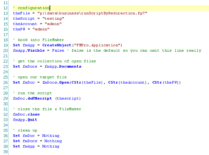

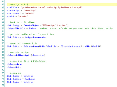

But if you just want to call a FM script completely outside of FM then there are ways in the ActiveX model to launch FM (hidden or visible), have it open a file, run a script and shut down again.
Care to share Wim? Pretty please?
I just want to open a file, run a script, close the file, all invisibily?
It's all in the help file, under "ActiveX"...
But just to make it easy (see screenshot).
Note:
- there is no error handling. What you really need to handle is checking if FM is already running (because this script will close it at the end)
- change the 4 lines below "configuration" to match your setup.
- save the file with a ".vbs" extension
