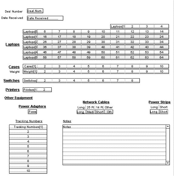

I have another table for shipping and another for receiving. Each record within shipping or receiving has all the equipment that was either shipped or received.
I've attached a picture of a simplified layout I use for receiving equipment. You'll see my use for repeating fields. I hope this helps.

If your layout however makes particular sense to the users will you be able to make cut up made vertical portals sans scroll each having their own relational key based on type constant and the multiline key!
Where entering something in a cell by eyeballing an empty slot, as in your approach are going to be unreliable since you without any kind of warning are abel to make double bookings of the same kind of equipment, instead you have to rolodex or search thru all records to watch out if an item is occupied. It's more or less you problem with the unrelational approach you have - and probably the reason for raising this topic??
You have a too paper-near metaphor, not quite recognizing what a database structure is able to do for you querry wise and are only using the flipside of the coin, the structural organization of the data.
