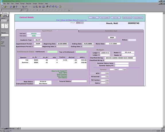

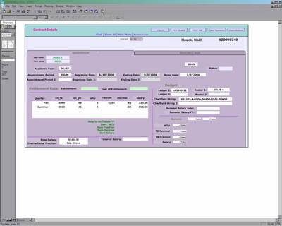

Thanks for the advice and I added another table (called Seasons) and it seems to work - reports and all. I am still in testing mode---but have run into a issue in the portal
So I have the contract details layout and there is a portal for the season (with quarter name ie Fall, Summer, wtu, fraction, salary etc). How do I create totals in the portal? I need a sum for WTU, Salary, Fraction, Decimal etc.
I have attached a screen shot for a better idea.
Thanks bunches
Never mind--- aye :
As a calculated field- Sum (sn_wtu) works
Thanks again... it seems that I need to bounce things off of this great forum, and then I get it and am embarrassed that I posted some simple questions
