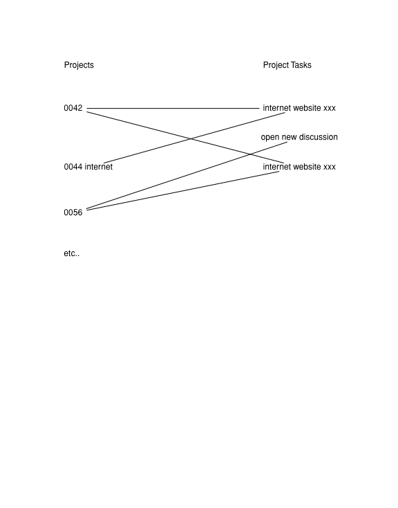

Relate 2 database with Projects ID
I have these 2 files connect like relational
there is a field called protocol in the Project Tasks (PT) layout Note, that I want to link to Projects (P)
you can see I connect them in the view Note Layout
[if ask for other file do not need to open just cancel]
the thing I cannot do is to put more option of the protocol field or add more Projects to a Project Tasks
like 3-4 different
for example
a field about movie 0056 can be connect to politics 0042 or internet 0044
Any solution?

there is field Project name [P] and Project Task [PT]
I want to link them.
For example a website of t-shirt [inside PT] can be part of many [P]

It would help me if you could explain what you're trying to accomplish. I see you have project ID and manager fields and that each project has one or more project tasks but to what end?

Are you wanting the (multiple) results from the protocol field to show in each line of the Project tasks portal in the PROJECT file?

I want when I make the link in the protocol to make association between different [P]
for example a [P] has many [PT], one of this is to have info about printer
the same [PT] can be associated to another [P].
Currently I copy the information into another [PT[ of a different [P], instead I want to link it

What you want is to have a many to many link--in other words a given P can have many PTs, and any PT can have multiple Ps. This requires a 'join table' and a portal. The join table will have fields for the ID fields of each table, and needs nothing else (although other fields can be added). Users select a PT from a drop down value list based on the PT table.
