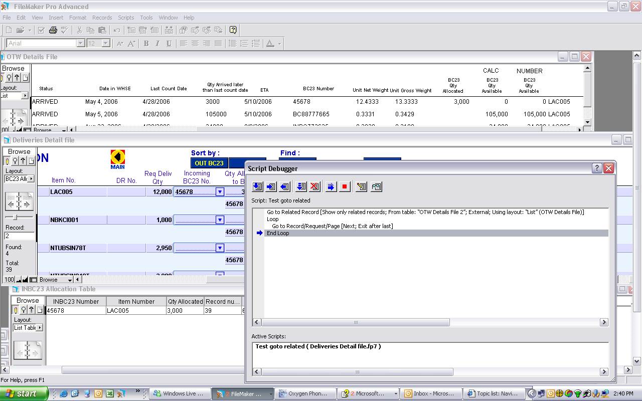

I stll have the navigation problem. Take a look at the attached sceenprint. I created a small script in the delivery detail file to show you what I mean.
As you can see, the related (child) file (OTW details - the incoming containers) is still on the first record, while its the parent file has moved to the second record.

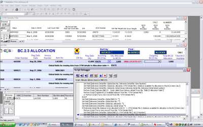

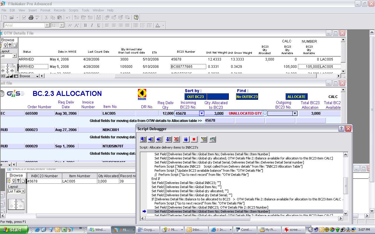

If you see the attached "screenshot2" you can see the delivery detail file in the middle, with a qty to allocate of 12,000. In the top file (OTW details) you can see that the first record has 3000 available, and 3000 has been allocated to that record, leaving a balance of 9000 to allocate. A record has been created in the allocation table at the bottom showing 3000 allocated.
The data is moved from the OTW details file to the allocation table by using global fields in the Delivery Detail file. You can see these global fields just above the script debugger window.
The script then moved to the second record in the OTW detail file (you can see the second record is highlighted) . However, when I set the global fields the data is coming not from the second record but from the first. You can see the first global field contains the BC23 number (thats the name of a Customs document) of 45678, instead of BC88777665.
