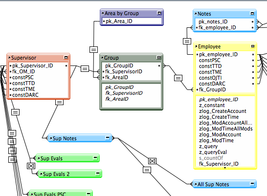

If you want the Employees to be linked to the Area they work in (rather than the Supervisor), then assign them to an Area (or a Group, where a Group is assigned to an Area). Then have the Supervisor be in charge of a Group rather than the Employees.

I still don't see the trouble. In my suggested structure, a Supervisor can supervise many Groups, an Area can have many Groups, and each Group can have many Employees. But a Group is not the same as a Crew. In this case a Group is a Group of Employees for supervisory purposes (the Employees that are Supervised by a particular Supervisor on a particular day, or whatever).
I looked at your graphic. I guess I don't understand how that will work. The employees belong to a sup, the sup to an OM, and an OM runs an area. I can get all of that to work. The problem is when I move someone to a new area, I only want their records to go with them, and not their relationship to others.
Under your example, are you saying, make everyone belong to an area instead? And if so, how to I make the relationship work between employee, sup, and OM?
Sorry, maybe I am just not seeing what you are saying.
Thanks Dave
To make my DB work correctly I need to have the employees linked to the supervisors, and the supervisors to the OM's. Can all those links still work with the group angle?
I had it all working, the only problem was when I wanted to move one employee or supervisor to a new area.
Under your way, I would just assign the employee to a new group. Then I would have a supervisor be assigned to run a group? The OM's run an area, so that one is not as difficult, I would think.
