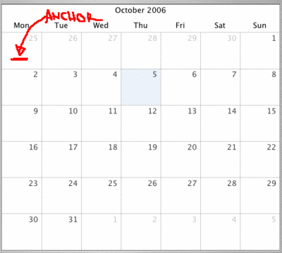

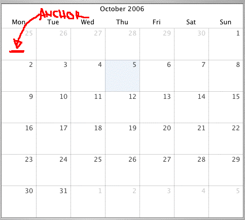

No. It will return 25/9/2006. As you can (hopefully) see, that is the anchor date for displaying the month of October 2006, with the week starting on Monday.

Okay so the anchor date is the 25th Sep.
The whole point of this is to get the cell that the first day of the month needs to start in.
I have attached a pic of this for the current date setup with the first day of the month as sunday, and with the first day as Monday.
Basically i don't need a date for the first monday on the calender grid I need to know the cell number, ie Oct 2006 should be 7.
