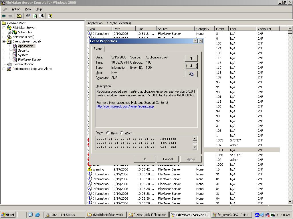

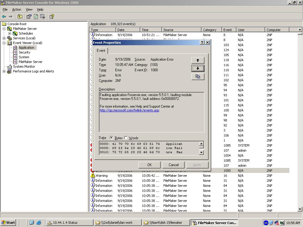

Yesterday, during a routine scheduled backup, my filemaker server 5.5 decided to crash - see attached pics.
We have a backup schedule that writes backups every hour, and this is rotated between 3 different locations so there will always be 3 backups of the work done in the last 3 hours. This has been working fine until now - for years.
Looking through the event logs, I saw that the crash occurred while the server was trying to backup the largest fp5 file which is 270MB in size.
Any ideas about why this could have happened ? My sysadmin colleagues assure me that the hardware and network setup are not at fault and are all good quality, although I have one suspicion that the server which stores one of the backups is being used for file serving as well and this may put it under more strain ?
Any recommendations about how backups should be performed ?
Thank you in advance !!!
Daniel
