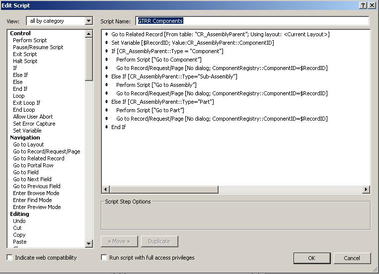

I have two portals in the bottom of my layout, one to show "parents" and one to show "children". I want to put a button on each portal row that will allow me to go to that record.
The tricky part is that I have a different layout depending on the record type (Component, Sub-Assembly, or Part), and different variations depending on the users security level. I already have scripts written to choose a correct layout depending on security level that I can call on.
Now the script I wrote, displayed above, works sometimes and other times goes to a record that I can't figure out why it would choose that one.
Am I missing a crucial step? I've attached the entire db for people to see what I want.

One thing that looks wrong in your screen shot is that you're setting the "ComponentID" into a variable $RecordID, but then later trying to go to record by calculation -- and your calc is ComponentID=$RecordID, which is going to return a value of 1 or 0 (true or false). So you're telling it to go to record 1 or 0, probably not what you intend.
Even just using $RecordID probably is not what you're after. "Go to record by calculation" is going to go to that record in the current found set, based on the current sort order. It has no relation to the record ID, it's just the position of that record in the active list.
You're already going to the related record (using current layout??). Why do you need any further "go to record" command?
The further scripting is an attempt to get the right layout based on "Type" and security level.
If I'm in the components layout (there are three security levels with associated layout variations), and I want to go to a parent layout, I need to determine whether it's a Sub-Assembly or a Part, then go to the proper layout.
The problem I'm having is that since Components, Sub-Assemblies and Parts are all in the same table, and I seperate them by doing a find, when I go to the related record I want it to look like it's going to the Sub-Assembly registry (only sub-assemblies in found set) or to the Parts registry (only parts in found set).
So the reason I'm trying to store the RecordID is so that I can go to the correct layout, find all records of the proper type, and then go to the related record.

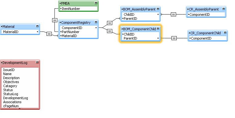

My relationships are rather complex as well. I've got a self join with a join table that the GTRR has to navigate. I've attached a picture of my Relationships diagram.

I'm looking for the script to work in my self join section, and you're describing it as needing two tables, will it still work?
My "ComponentRegistry" table is the main table, and it's self joined using a join table (BOM) to itself to give me a parent/child relationship structure.
I want to go from one record in the Component Registry to another record in Component Registry. Which should be easy, but since I'm sorting all the records in that table into three catagories (Part, Sub-Assembly, and Component), and the record I want to go to may be in any one of those catagories, it gets complicated.

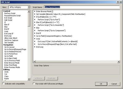

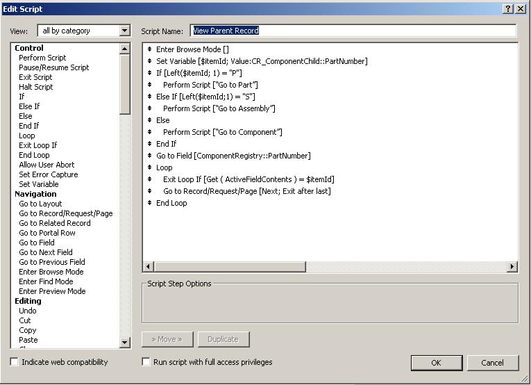

The only other method I can envision for doing this would be to set the ID into a $variable; then Find; then loop through the found set until ID = $variable. (You could use a global instead of a variable, but we don't need to in this method since we're not using it for a relationship.) This method will be slower than GTRR, but depending on the size of the found set may be acceptable.

I got it working using a find, then a loop.
I wasn't able to use the global and gtrr method, it wouldn't work for me. I don't think I really understand it properly.
Are there any examples anywhere that use this technique? The loop method works for now, but if the other method is faster I would like to use it.
