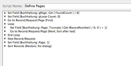

I think I found a solution to your problem. I had the exact same request made to me by an employer & thought yeah, FM can do anything. Well here is the secret. You have to define how many occurrences per page.
Add a field to designate the page that the record will be found upon. (Page Number for ex.).
When defining parts, tell FM (in the body section) to make a page break after so many records - in my DB I had six per page.
At the end you will need a Summary Part and also a sub-Summary. Your Summary Field will go into both these parts. When you define the sub-Summary, FM will ask you under what sort conditions it should appear. Define this as the Page Number field
You figure out which pages the records occur on by simply by dividing the Record Number by the whatever number of records you choose to appear per page (in my case 6).
There is a little trick tho: You've got to slip in an empty record onto the first page, Otherwise you will be missing one record on your first page and when you sort that will throw the entire report out of whack by one record.
Hope this helps.
Earlier in this discussion it was mentioned that having the summary from the previous page at the top of the page would also be useful. I thought so too.
I did it by carefully measuring the number of records that would fit onto one page which is necessary for the procedure that I posted before. The cool thing is to extend the sub-summary to be a little longer than able to fit on a page, add your Summary Field at the top and bottom of this Part, check the option to have this section extend to the next page... Voila the second summary field which contains data from the that page is extended to the top of the next.
The key tho, is careful measurement! Millimeters count, because as you add pages - if the layout parts dont precisely fit, those extra mms will creep onto the later pages. This shifts the sub-summary section and eventually it ends up in the middle of the page.
