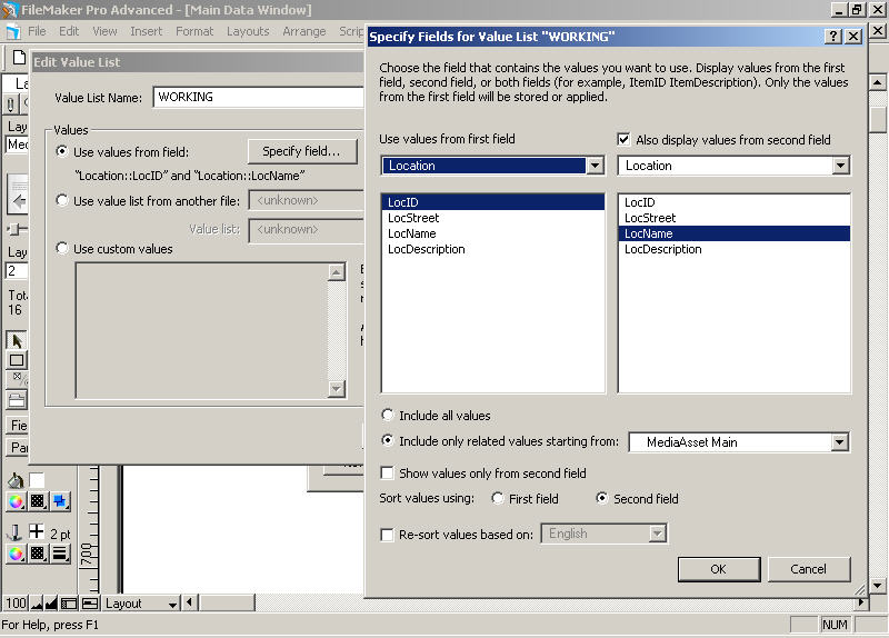

For the problem on hand, make your value list look like this image.
