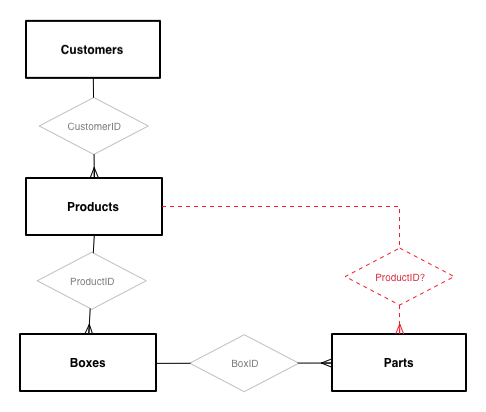

I am still missing pieces of the puzzle, for example - what happens the next time a belt comes in? Do you use the previous record as the basis for the current job, or do you start all over again?
In any case, if you would modify my example by adding a table, say SoftwareItems (related to Software by SoftwareID), then you could select the SoftwareID to install from, and show only related SoftwareItems in the source portal.
It looks like you are assembling a new product from the parts of one or more existing products. If so, a Part can only belong to one Product at any time, so you don't need the join table (Installations in my example). You could just shuffle parts from product to product by changing the part's ProductID - see attached example.
Note that in real life, there would be probably be a Job table, and Products would belong to a Job. That way the From portal could automatically show all parts from the Job's products, instead of user having to select them manually.
PortalToPortal2.fp7.zip

To try to simplify what i am doing.
Imagine this in a PC Store:
1. You have a (tableA) layout for PC Parts.
It has the fields:
[inspection ID] - Unique ID for each record
[customer] - growing valuelist for customer names
[type] - part types
[amount] - part amounts
[total parts] - summary of total parts supplied
2. You have a (table :o layout for PC Complete systems.
It has the fields:
[depstach ID] - unique ID for ech record(not same as tableA)
[customer] - Valuelist looking at entries from table A
[type] - type of system customer wants returned
[inspection ID] - valuelist of related(customer + type:;) tableA) table A record inspection iD's
[type] - valuelist from table A of the type of parts supplied
Customers give you a box of PC components(ram, motherboards, hdd, processors etc) all disassembled in that box.
The customer(say customer X) wants you to give them a Desktop PC Complete ready for use.
So, you proceed to create a new record [inspection ID 001]in table A (for Customer X)to list all the individual components in the the box they supplied according to their types and the amount of each component.
You realise from the inspections that there are many different parts, but NOT enough to complete a Desktop PC as the costomer wants returned. ((There may be 3 hdd, but no case etc.....))
So you ring the costomer (customer X) and notify them of the results, so they send another Box of parts to you.
So you create a New Record in the Table A for this box of parts. (Now you have enough parts).
((This new record will be [inspection ID 002]))
When completed, you go to the table B layout and create a new record for the customer(customer X).
You proceed to enter the customer name(customer X) and the type of system(Desktop).
Then using the 1st valuelist [inspection ID::tableA] you select the record [inspection ID 001].
Then using the 2nd value list under the 1st, you proceed to see a list of the parts listed on the table A Inspection ID for record [001], so you select the part you need.(7 repetitions for each valuelist).
Select the ID & Part until there is no more parts required from [iD 001].
Then requiring still more parts(not in [iD 001], you go to the next blank repetition of the 1st valuelist and select the [inspection ID 002] record, then with the valuelist under that valuelist you select the required part(2 x Valuelists One above the other... [inspection ID::tableA] & [type::tableA]).
Continuing on until enough parts are gained to complete the system.
The Desktop PC once completed is then given back to the customer.
!!!! NOTE:
When a PART(type) is selected in the depatch sheet(tableB) from a valuelist, that part(type) because it is being used CANNOT be Used AGAIN as it is no longer available for any other Desktop PC's for that customer.
EG. Say customer X supplied you in boxes 1& 2 a total of only 1 Case.
You used that case in the 1st valuelist of (types)in table B, so when customer X comes back in 12mnths time and gives you more parts in a box to make another Desktop PC, AND no case was supplied, i want the CASE to NOT be LISTED in ANY records in table A for customer X, as it WAS USED in a previous table B record.
So it is with ALL USED parts(types).
This is basically what i do with belt instead of PC parts.
I nned to give the employees a 1 page sheet for them to manually list ALL bits and pieces in the box of parts.
Then i enter this into Filemaker Pro.
Then when i know what the customer wants returned, i create a table B record an list all the parts i need from each individual record(box) from tableA.
I then give this back to the employees to show them what parts they need to put together to make up the Desktop PC for the customer.
Hope i have put what i need into a more understandable senario of what i do.
My AIM is:
To REMOVE ALL Parts that have been USED(Displayed/Shown/Used/Utilized) in Table B from the Valuelist to prevent it being accidently listed to be used AGAIN. (It is NO LONGER AVAILABLE as it was used in a previous PC).

Thank you for the time to reply to my problem.
To clarify i have a attached a picture of what i would need according to the picture you posted.
Is that what you meant?
Corey....
I don't think so. The rectangular boxes represent TABLES. "Inspected RollID's" and "Despatched Roll ID" sound like FIELDS.
If I understand correctly, my "Boxes" are currently your "Inspections", my "Parts" are your "Lengths", and my Products are your "Dispatched Sheets". But hey, it was your example I used, so you should be able to map it back to your stuff.
