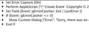

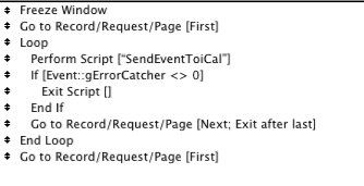

No just rewrite the scripts using a global field instead for the storage of errors - Like the attached snappies!
