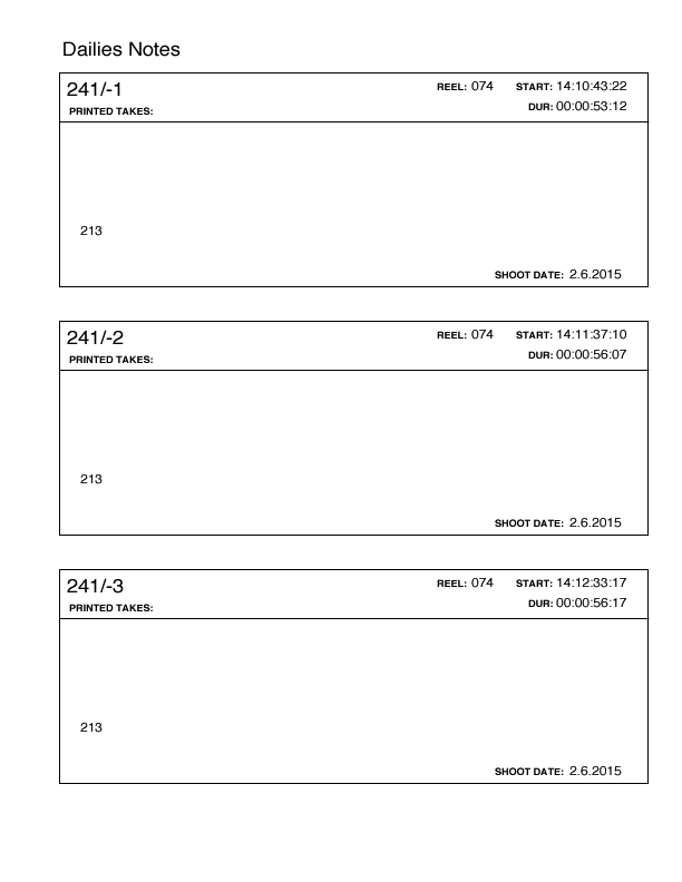

This page shows how the pages need to be formated. Each box is a record. They have to be ordered by Reel, then Timecode, the scene number is in the lower left of each box. Whenever that scene number changes, then there needs to be a page break.
That's exactly right. There would be 50 pages, but that doesn't happen very often. The report is for the film's editor and director while they're screening footage. The editor writes notes in each box. The report has to be in the order in which they watch the footage (reel then by timecode).
The page break is because this report will later be physically reordered into a separate binder in order of scene, so records belonging to two difference scenes can't be on the same page.
The report needs a page count because the first binder gets very large and occasionally a director wants to jump around on the tape. I have to be able to quickly tell the editor which page to turn to.
I don't think the problem is with page numbering. That only came up when the sort order was changed - but we have just established that you cannnot do that.
If you want to print this from Filemaker, I think you will have to generate one or two dummy records for those instances where the number of clips in a scene is not a multiple of 3. This is easier to do than to explain - take a look at a somewhat similar problem here.
Yeah, I know what you mean. I thought of doing something like that earlier, but I thought it was going to be too much trouble. But now, when faced with manual reordering, it's probably the lesser of two evils.
