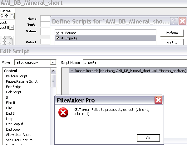

Hi Fenton
I'm trying to do an import, but this error comes up...

Daniele, when you get an error on the 1st line and column, it usually means there's an extra character in front of the declaration. This is usually because of an encoding problem, such as utf-16 or something; xml is supposed to be utf-8, and that is how I'm trying to save it. It's a little difficult to troubleshoot because it's invisible unless you use a dedicated text editor (not a word processor).
For Windows there is Programmers Notepad. For a real xml app there is Altova XMLSpy. It has a free version, somewhere there on the site; pretty awesome.
