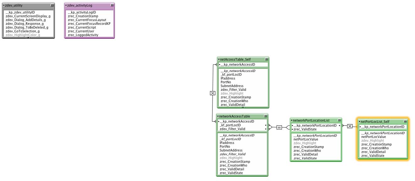

I've attached a screenie of the Relationships screen.
For your purposes, ignore the extra table instances with the "_Self" suffix. Those are self-joins needed for a user interface trick I'm using and don't affect anything else.

Define "main." Technically, both these tables are sub-tables in a much larger framework. I'm building bottom-up.
In this pairing, it works left-to-right, with [color:brown]networkAccessTable is the "main" table, with [color:brown]networkPortLocationList only serving as a means to dynamically manage a popup list (i.e. it stores the values).
The two tables suffixed with "_Self" are instances of the table with the similar name they are joined to and are simply for user interface purposes.
[color:brown]zdev_utility is just a place to stick global utility fields, mostly for user interface purposes. This particular system will be disabling much of FileMaker's built-in interface in favor of it's own.
[color:brown]zdev_activityLog is a log of all operations for historical record. Since much of the UI is controlled via scripting and custom elements, this log can easily track every change made in any table from any script-driven element.

Three screen shots attached. One is the Relationship dialog as I've got it set. The other two are the two different ways I've tried the Value List. One is all values, which will cause the popup to display all values, whether Valid or not. The second shot was just my blind attempt to mimick the "include related values from" I saw in your example, without truly understanding exactly what you're doing with it. When I do this the popup says no values were returned.

Anyway, Try taking out the ID field out of the relationship ( _kf_portID = whatever) and just leave the calc field linking to whether it's valid or not -- PortLocations2.jpg is set up correctly assuming you want a list of all valid ports (if you change the relationship as described above)
HUZZAH!
That worked! The popup in my layout to create a new [color:brown]networkAccessTable record is giving the expected values.
Of course this solution caused another layout to start showing the key field instead of the value, but that I should be able to suss out.
